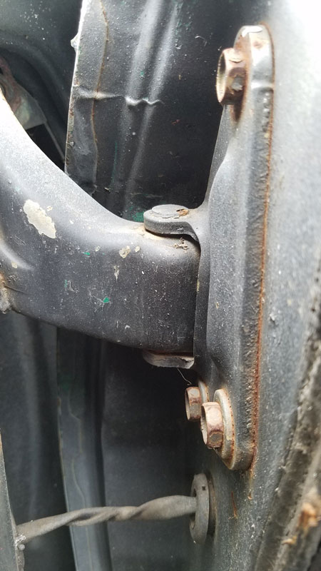

I got hinge rebuild kits for Christmas, so I took a look at the challenge today. The way the top edge of the door curves over, it doesn’t look like there’s space for the pins to come up unless you unbolt the door from the hinges and take it off.
Can you replace the pins on a 67 without removing the hinges or am I going to need a buddy to help me take the doors off?

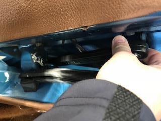

Well, the Tite Reach extension wrench does work on the hard to get to bolts of the door hinges on a '69. '67 and '68 should be very similar but I can not attest to it.
My 1/4" sized Tite Reach was able to get to the hardest bolt on the hinges with little problem. The other two bolts on each hinge that attached to the car body could be reached with a u-joint and a regular long extension by opening the door all the way and getting to them from the outside near the fender. My 3/8" Tite Reach was too large (fat) to work.

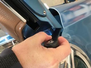

See attached pics of the one that worked.
(Yes there is a 1/2" short socket on the extension actually on the bolt head. I just don’t have the ratchet hooked on in the pic)
Hope this helps.

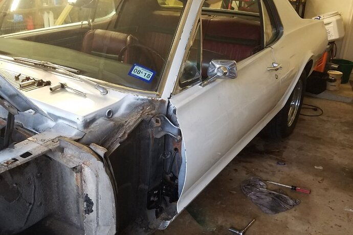

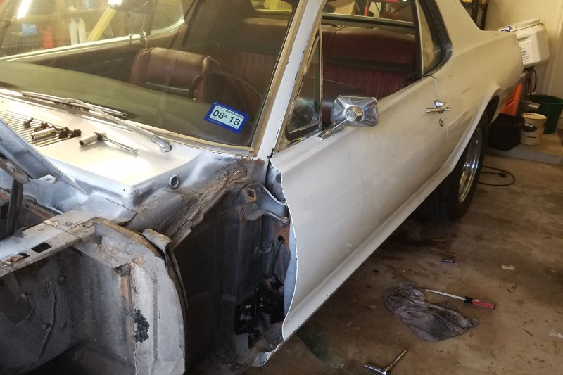

Well, I could not get the Tite-Reach wrench to fit. Instead of going back to one of the many other projects on my list, I rashly decided to remove the drivers door.
On the upside I did get the top hinge rebuilt. On the downside the bottom hinge had to come off the car completely, and if I’m not succesful in drilling it out tonight, I’m going to have to throw it away and go buy another one.
I have hopes that with the original hinge locations clearly marked, I can get the door back on correctly, but I know that realistically, I’m probably going to have to pull the fender off, then put the door back on, then line the fender back up.
Good times.

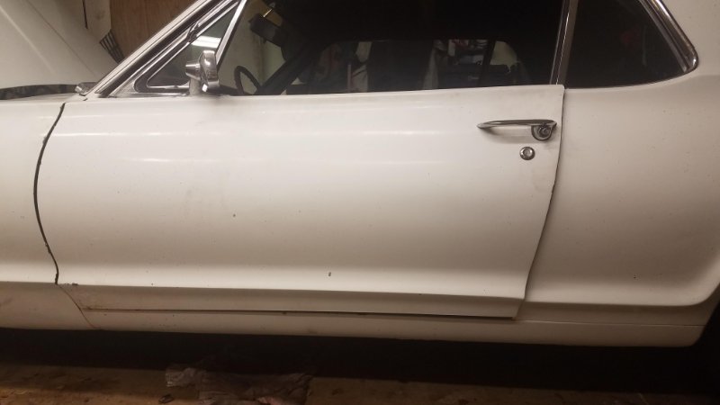

The great news is that my door doesn’t sag anymore.
The bad news is that it doesn’t shut now either.
Guess I’m pulling the bumper and fender this weekend.
Glad I did all this when my body work was done! This does not look like a fun job with a fully assembled door and car.
The fender comes off easily without removing the front bumper or grille. Just unbolt it from everything. Door adjustment needs to be doe with the fender removed.

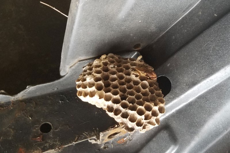

Thanks for the encouragement, Royce. Getting the fender on and off wasn’t as daunting as it seemed. However, I’m glad the residents had vacated before I yanked it.
Once it was off, I loosened all the hinge bolts, then I shut the door and held it in place while my wife tightened the bolts back up.

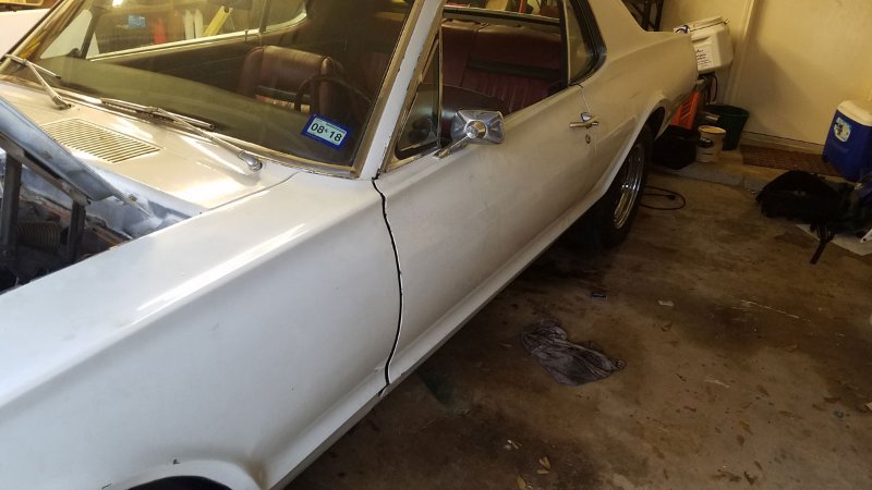

While the back edge of the door looks great, the front gap seems pretty large, but I’ll come back to that when I’m finally ready to paint.
Going to tackle the passenger side this week.
your fender gap may simply be you fender needing to slide back a bit. You want to alight the door to the body/rocker, hood to the cowl then fender to hood/door.
