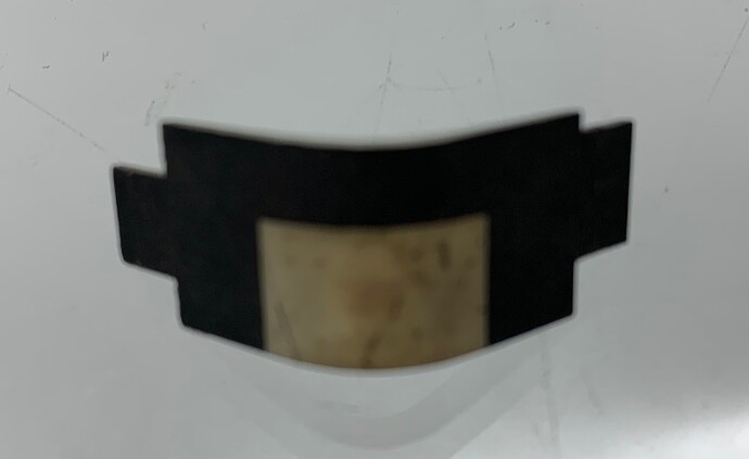

Can you reproduce this plastic part? 67-8 Console light diffuser
Someone out there could find a sheet of translucent plastic, cut these out and paint the black area. I would buy hundreds… They are so rare most folks do not even know they exist on 67-8 console cars.

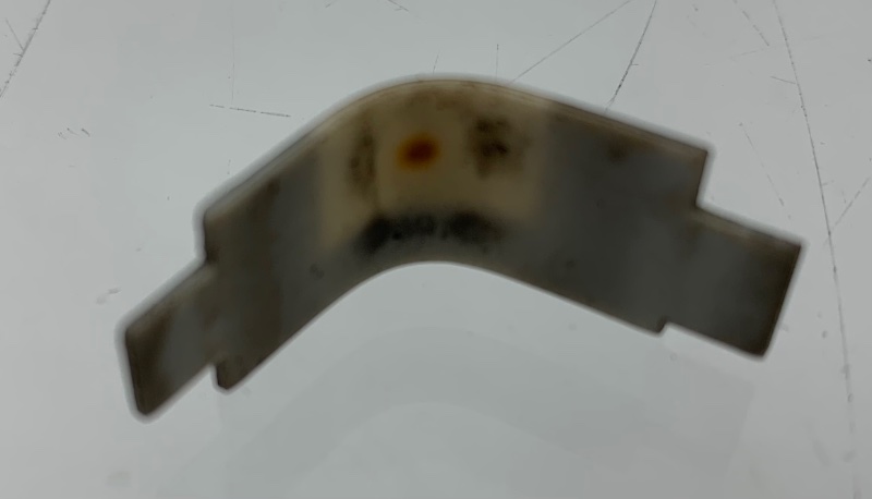

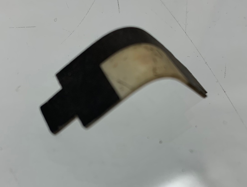

A utility blade and straight edge is all one needs. The heat from the bulb makes them permanently curved but the new part is flat. Painting would take longer than cutting the thin plastic parts from a sheet.

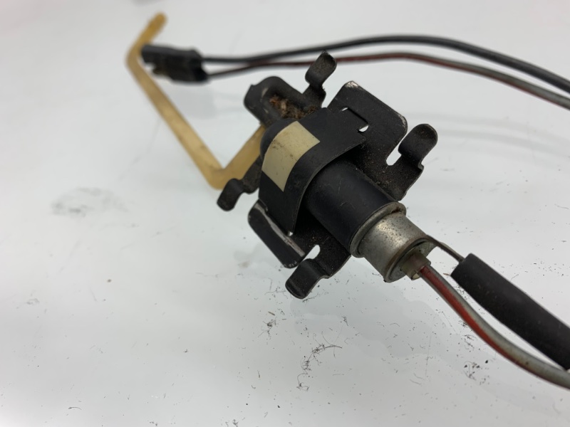

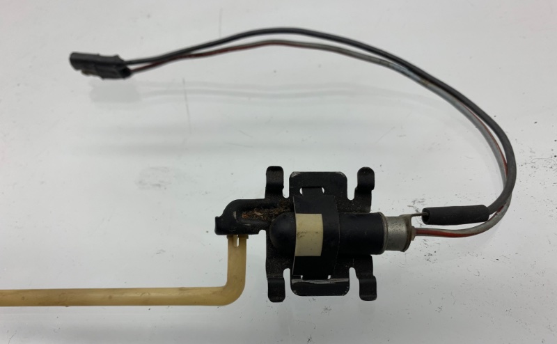

Don, where exactly does this part get installed, is it for the shift selector light for an automatic equipted car ?

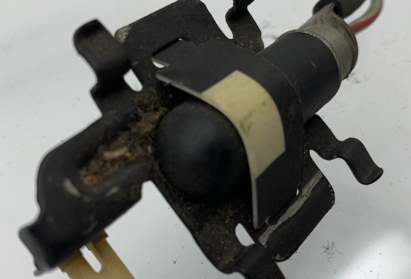

. It snaps into the slots

Without this diffuser the bright light will illuminate the adjoining letters.

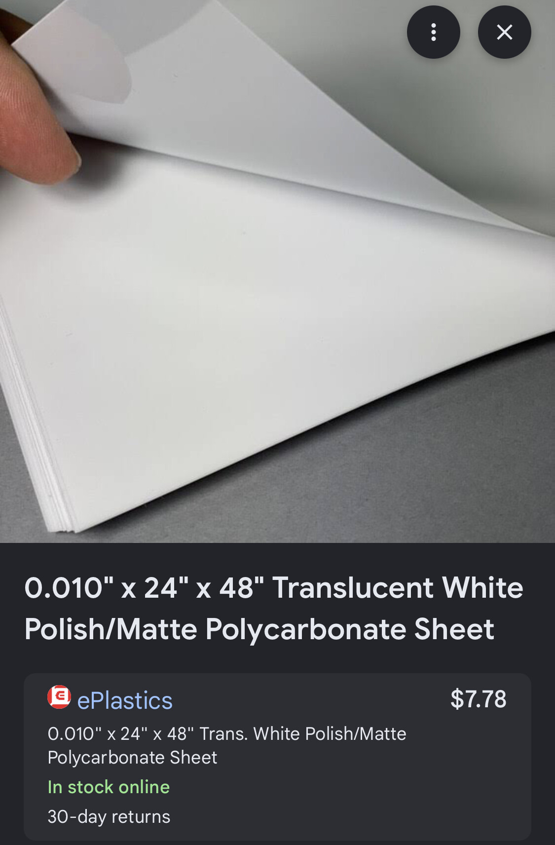

So anyone get a result to this?
If not what thickness and product should I get to make my own?
I’ll try this and let yall know how it looks. Pretty cheap, but I paid more in shipping than the piece lol
