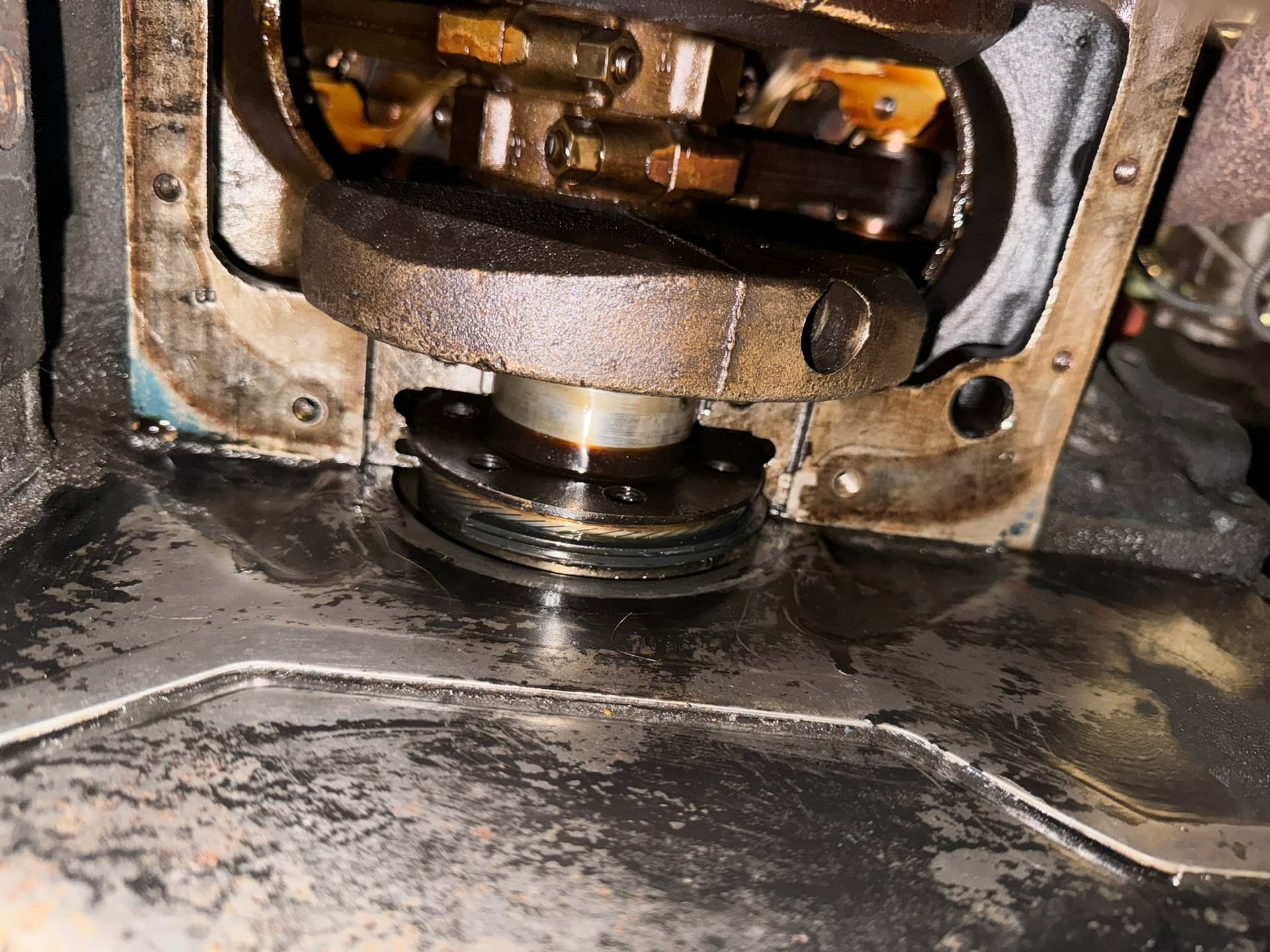

I thought the toughest part was removing the old rope seal, but the problems just started - I can’t insert a new rubber seal! It goes in about 1 inch and stops. I can’t tap it in this position; everything is slippery with limited access.
I followed the repair manual and loosened the main cap bolts, but no use.

I tried one more time. It doesn’t want to move any further. Stupid design. It would be easier to remove transmission than deal with all this mess.

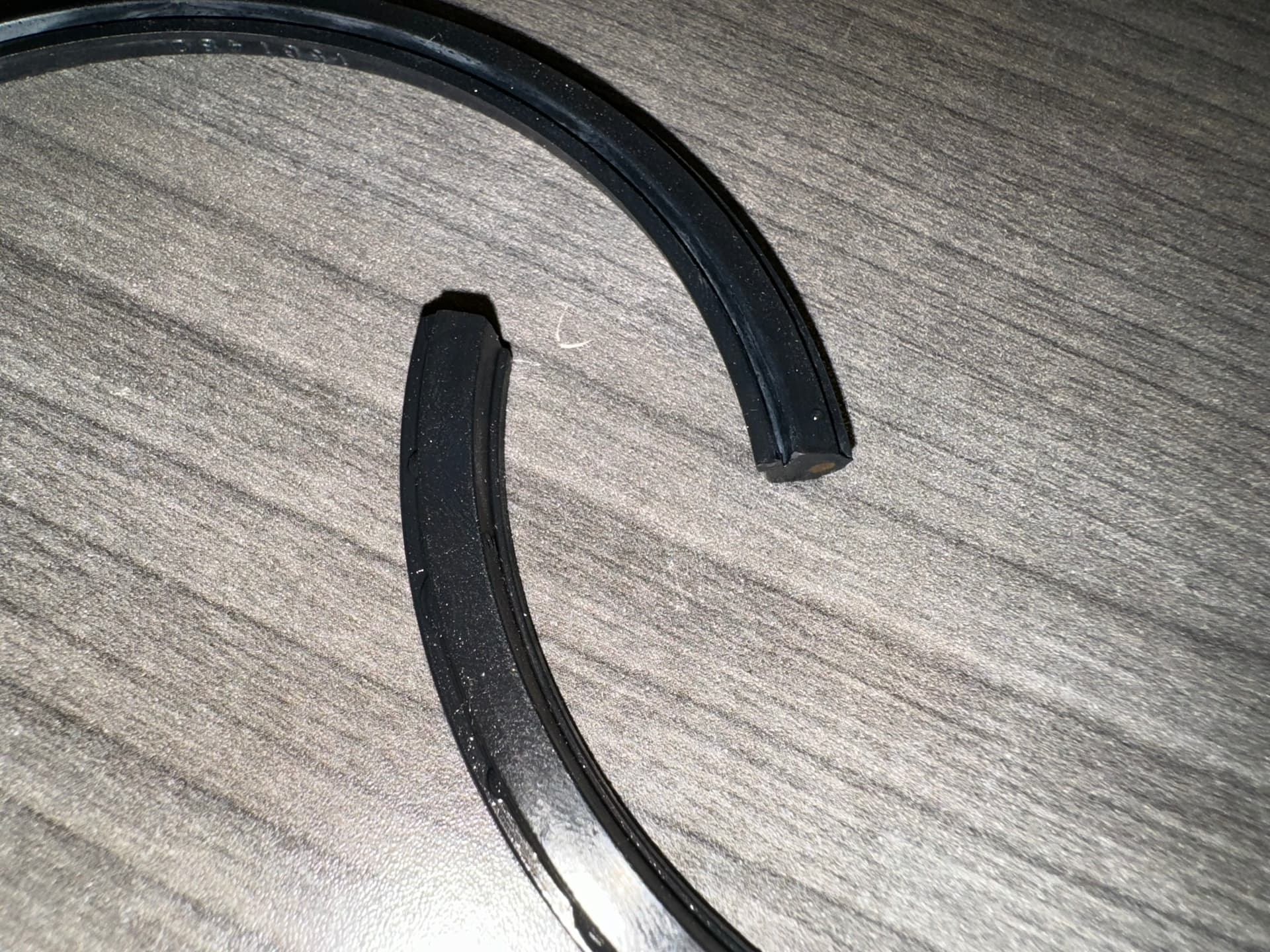

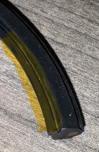

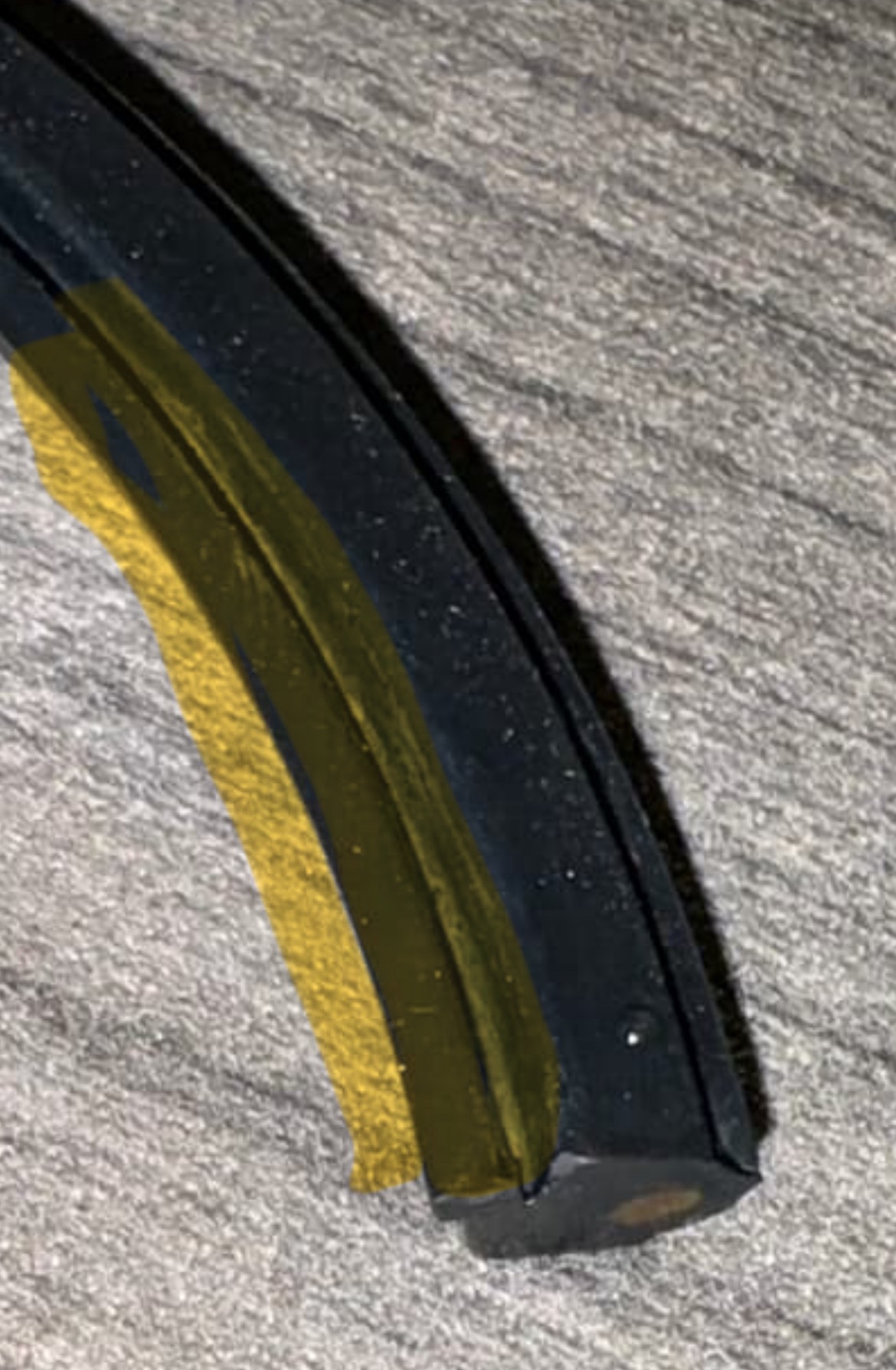

Let’s get some pictures of all sides of your seal. It doesn’t look quite right. You have the fat side of the seal facing the inside of the engine?
Here it is. By the way, I have two seals: one made by Fel-pro, and one made by Mahle. And they are absolutely identical - it looks like they were made in the same factory in China.
I can’t tell from your install attempt photo, but the edge with the groove faces the inside of the engine. Any small pressure within the crankcase causes the seal to seal better.
So at the edge you are rotating into, you should be applying as much finger pressure as you can at the parting line you are pushing into. If that doesn’t work for you, I’m not sure what else to tell you.
