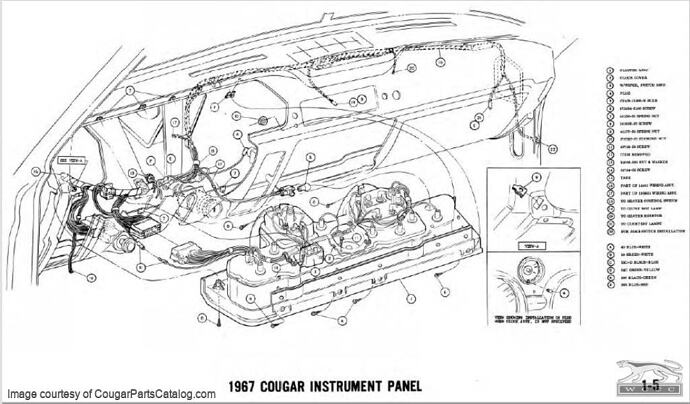

Ok, just searched your prior posts and you have a 67, I thought seals and innards were engine comment but they weren’t. Since you mentioned wiring I would download (for free from WCCC) the schematic link below. Another possibility is you’ve got a vacuum problem, I would double check that along with Royce’s suggestions. Vacuum issues can have you chasing ghosts :smoke:
It is so sweet to jump into a 100% stock 2V small block and turn the key as per the instructions on the visor and have it start instantly and be able to put it in gear and go on a cold day. It really is that easy on a perfectly tuned engine with operational choke.
https://secure.cougarpartscatalog.com/dl0229.html?attribs=75

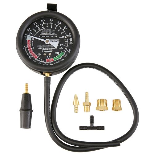

I finally drove it over the weekend and it’s running way better but still stalled when pulling it out. I’m now thinking it might be the vacuum. Any suggestions on vacuum gauges?
Pretty much the same, just depends on whats local to you :smoke:
https://www.napaonline.com/en/p/BK_7001715
The overwhelming help is always much appreciated. I should have posted much earlier as I think I have finally fixed the problem. After originally thinking it was the floats in the carburetor or the timing, I finally checked the vacuum pressure and it was super low 10-11. I went ahead and changed the vacuum advance, which then advanced the timing. When I dialed the timing back and adjusted the carburetor the car is now running at about 15. It sounds way better and has yet to stall in reverse. Thanks for all of the help. Hopefully this maybe helps someone else.
