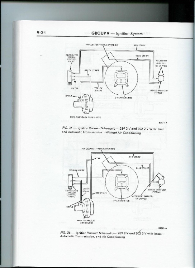

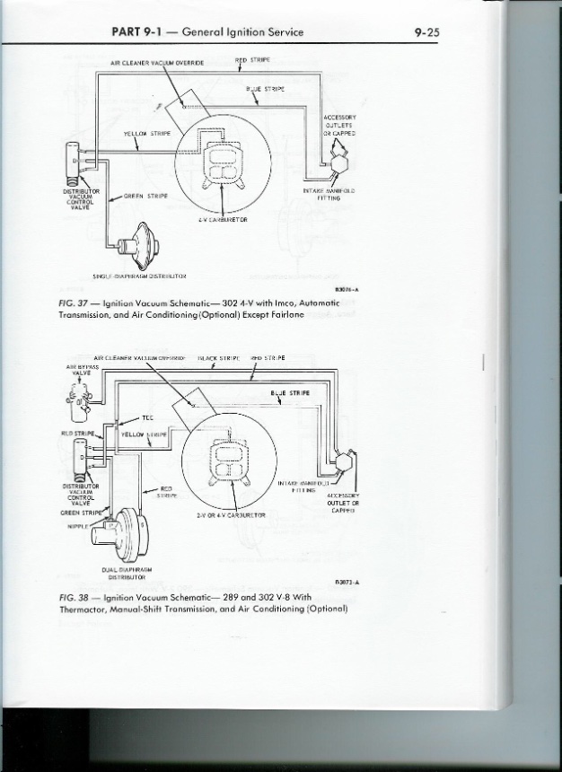

The distributor dose not supply vacuum. Vacuum is applied to distributor from the carb/ intake manifold to activate the diafram with in the disrtributor. Also the vacuum that is applied to the distributor is usually routed through a distributor vacuum valve that is screw in to the thermostat housing. See atached diagram’s

Ok now I’m super confused. My carb is an Edelbrock 1407. I’ve only had the car about a month. It has a vacuum line from the distributor to the left side of the carb which the online instructions says is timed vacuum. Right side is manifold vacuum and it’s capped. So do I have it hooked up right? I think I was checking it backwards. I was checking for vacuum on the line FROM the dist and should have been checking it FROM the carb.
Ok. The vacuum comes FROM the carb TO the distributor.

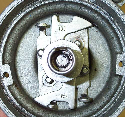

This is almost right. The stock distributor has two limit slots on the internal advance arms. One is probably labeled 15L for 15 degrees of cam shaft advance (30 degrees at the crank) and the other is probably 10L that will give you 20 degrees at the crank. See how this works? 6 degrees initial advance plus 30 mechanical gives you a total of 36. With modern gas, you have to run a richer mix at idle, so you can easily run more initial advance. The engine will run a bit cooler, show a stronger vacuum signal at the carb and transition better when you tip into the throttle. The only problem is that 36 degrees can be slightly too much advance depending on the compression of your engine. The alternative is to run 12 or 15 degrees initial advance and swap over to the 10L slot to get 20 degrees of mechanical advance, for a total of 32 to 35 degrees advance. The arms in your distributor can have different values, 13L and 18L are also common.
