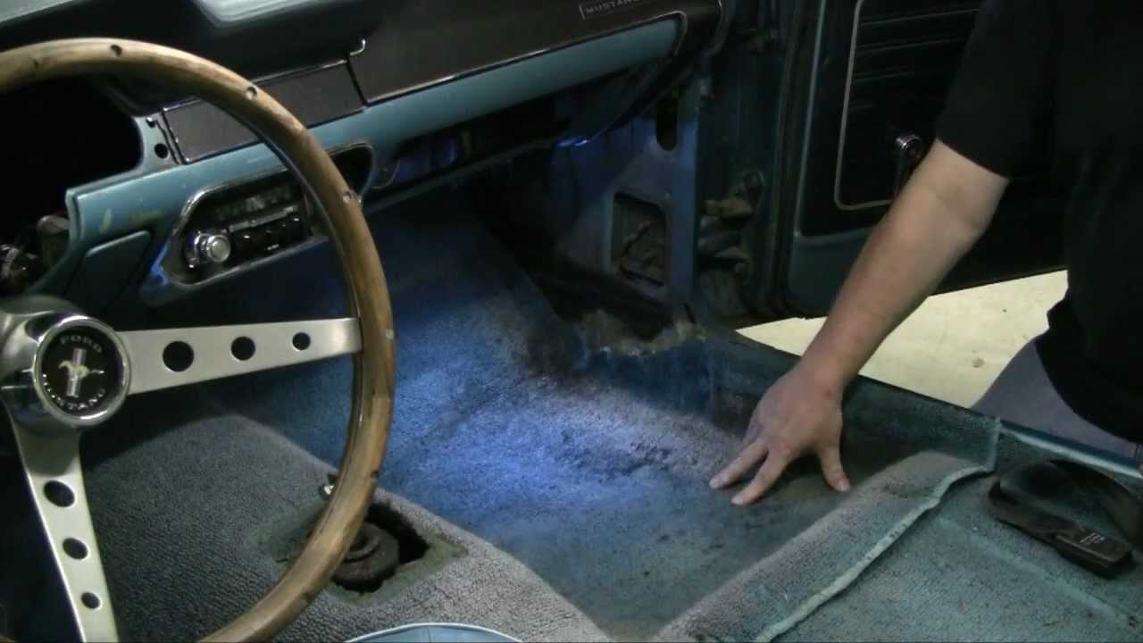

Refer to the WCCC video on youtube on carpet installation. Good info and tips & tricks
