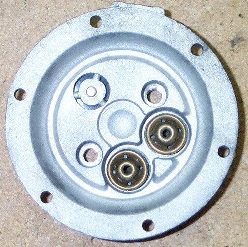

My fuel pump started to leak last week. When I opened it up, I find it does not have the same fuel check valves that are included in the rebuild kit. I accidentally knocked a hole in one of the rubber gaskets so I cannot simply reuse them. Has anyone seen this type of valve and know where I can get a replacement? Thanks.

However, the three one way valves in the kit are not the same as my configuration.
The first picture is a standard pump that fits the rebuild kit one-way valves. Note the center circle in the upper left in which the small post of the valve is pressed.
The second picture is mine. There is no center circle for the post to press into. Instead the whole valve presses into the hole. The removed valves are to the left of the pump. These are the valves I need, but cannot find.
Looks like the center of your pump was replaced with some sort of non - Carter part. I don’t know what you could do except replace it with the correct Carter part. Maybe buy a used Carter fuel pump on eBay to get that section.
