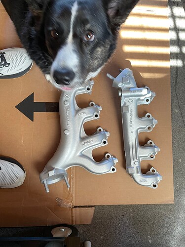

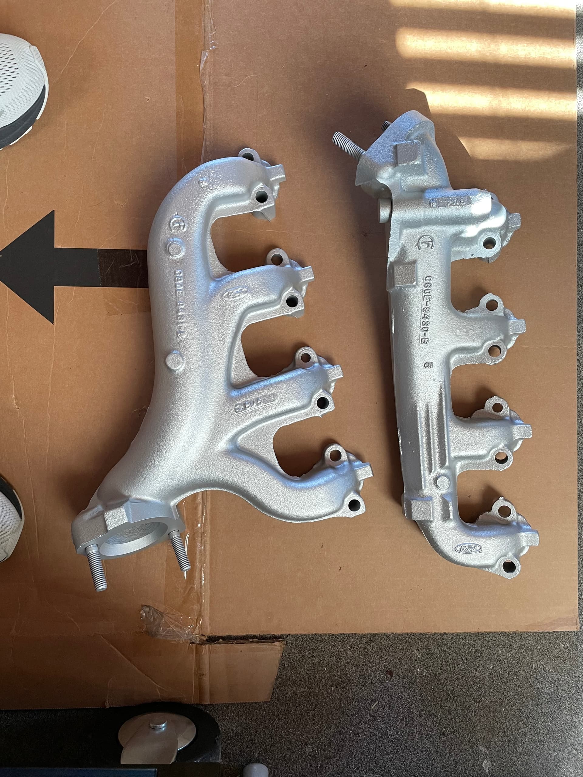

While the block and heads are at the machine shop for a cleanup I looked for options for the exhaust manifolds and found a local shop that does ceramic coating. For a VERY reasonable price they baked and shot them repeatedly until they got all the oil out, and this is the result.
They also come with Roxie’s seal of approval.
Looks fantastic! So did they just clean them up, or ceramic coat them once clean?

He blasted them to remove the rust and repeatedly baked them to remove the oils. He did a full coat that didn’t meet his standards, re-blasted, baked overnight to get the last vestiges of nearly 60 years of oil drippings out and coated them again for this finish. He said he now knows to start with the heat process to get the oils out on these parts, so future work will be a one cycle process.

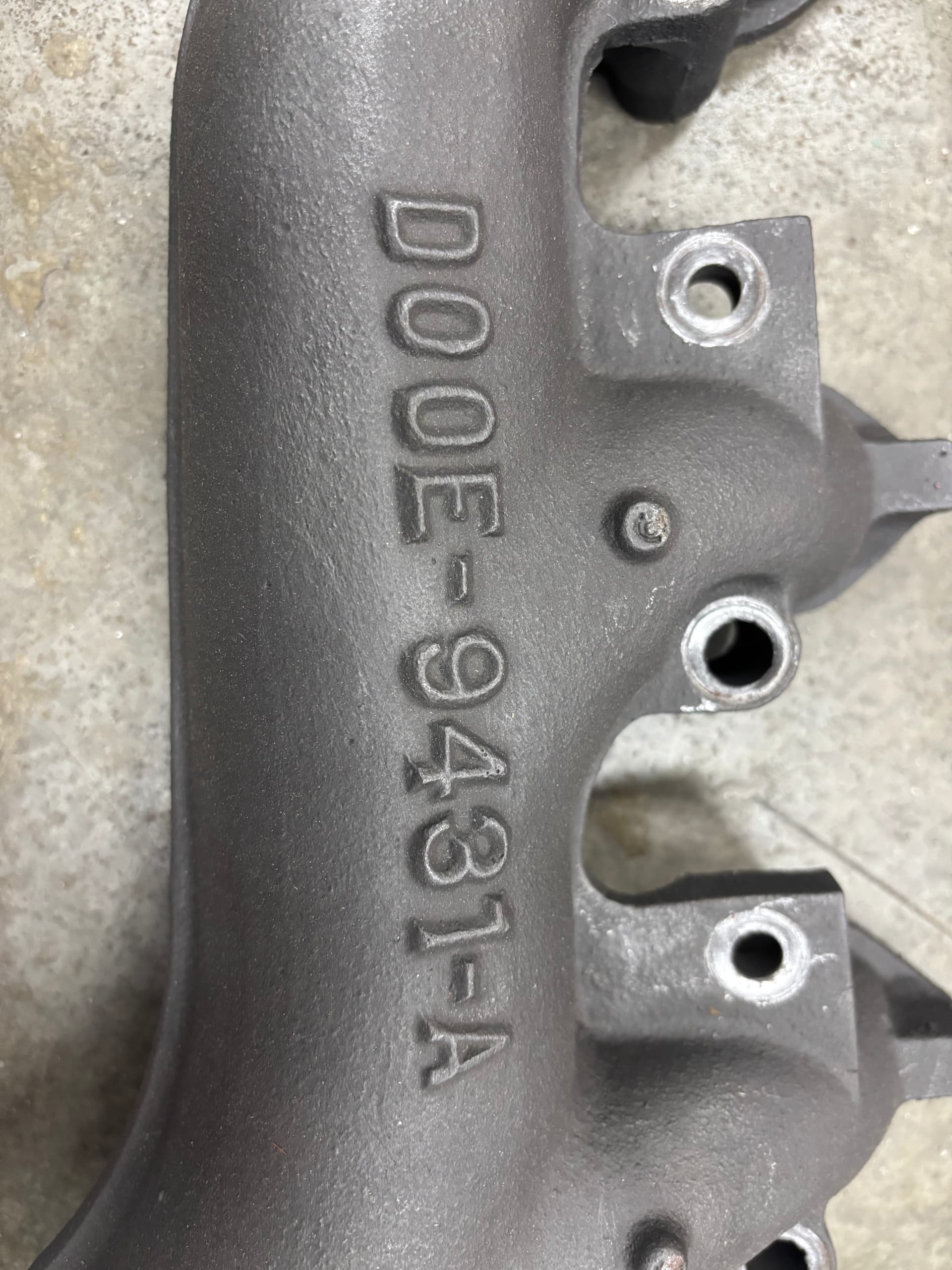

I prepped the manifolds with a wire wheel/brush and an acetone wipedown before spraying 3-4 thin coats of Slip Coat.
Here’s a 429CJ manifold 3 years after coating with Slip Plate:
Nice finish, and in some applications an improvement over the bright ceramic I chose. I also have heat transfer issues to a Borgeson steering box, so combined with a heat shield sleeve over the pipe running back from the manifold and beyond the bellhousing, I am hoping for some significant drop in heat. Once I have the car back together and can test, I’ll let everyone know if it made an impact.
