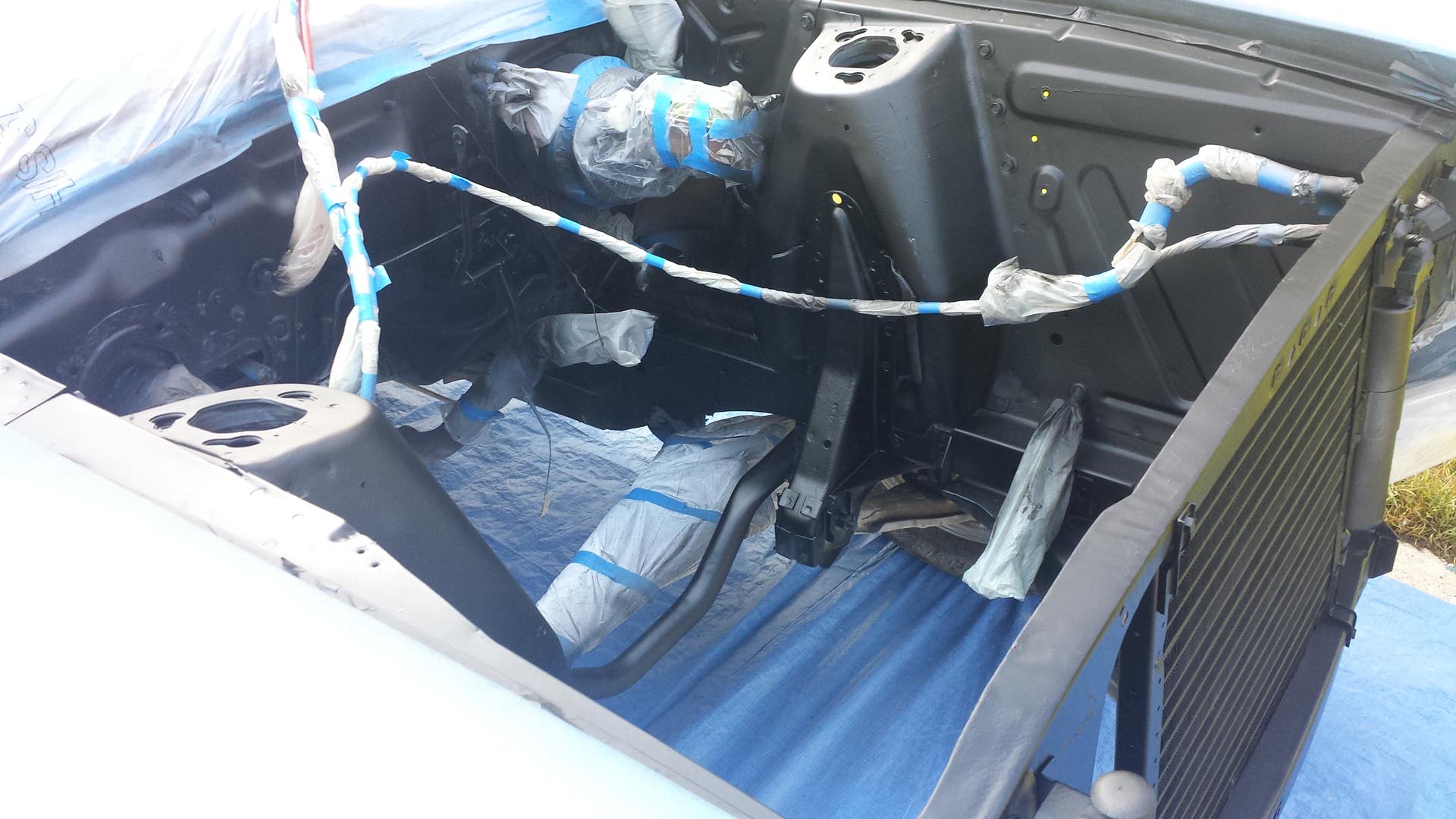

I just finished blasting/priming/painting the engine bay. I used a PPG epoxy primer and a black paint flattened to an eggshell sheen. Turned out really good.
Hey, that came out nice, did you paint the A/C condensor also?
