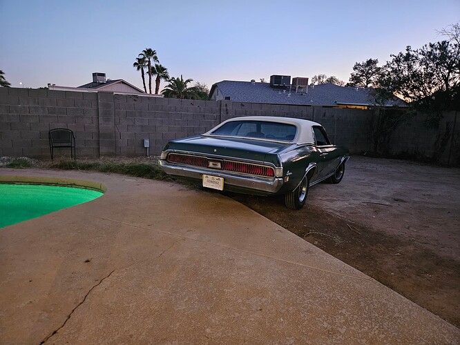

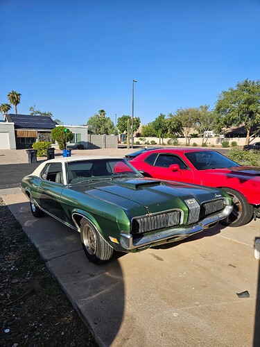

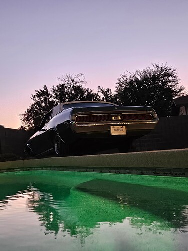

Sorry for a long read for a simple fix, I’ll toss a few pictures of that emerald beercan sitting next to the pool to make it worth your time.
