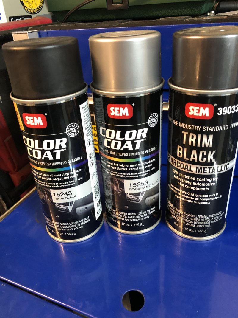

I sanded everything down and then started with the SEM Black landau interior paint. The chrome then went over that, and then was clear coated. After spending way too many hours on it, I’m tempted to just go all black and call it a day.

I had originally used the SEM titanium metallic then changed it to argent silver using the motorcraft ford paint

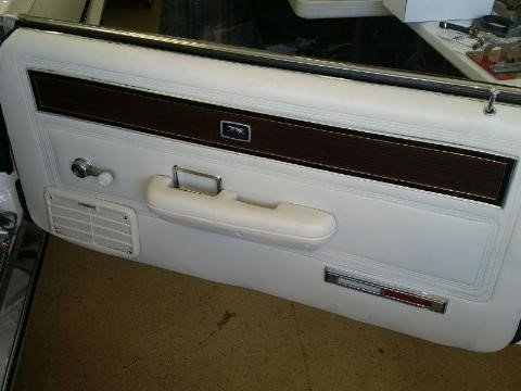

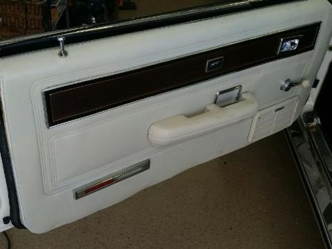

I used the model foil on a set of 1969 Decore door panels recently, and they came out very nice. It is self stick, and has a good adhesive. Bought it on ebay for around $20. One package was enough to do both door panels. Take your time and use an exacto-knife, and it will turn out nice!
