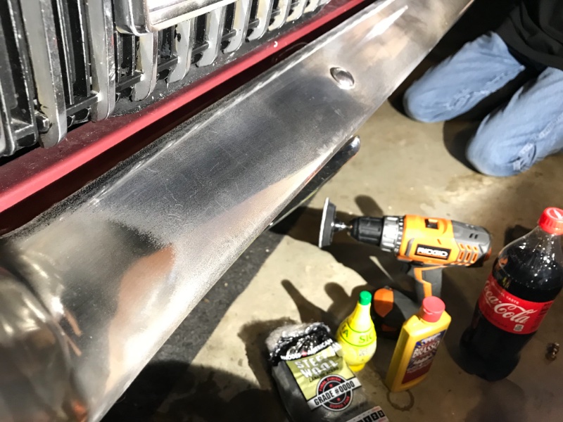

Tried the 0000 steel wool.
Chrome polish
Coca Cola
Lemon juice and aluminum foil
So far with negligible results
Maybe try the steel wool and dish soap with water, I have done that its cheap and easy.
Looking at that picture of the front bumper, I would speculate that the area where it goes from shiny to dull on the left side could now be wheeled and possibly shine up. The imperfections will still be there but it may shine up. It almost looks like the chrome is sanded off?
Good Luck
Gary
Thanks. What do you mean “sanded off”?
Can Chrome come off?
Chrome is just a coating. Chrome can be sanded off or if rust develops under the coating through a scratch or crack in the chrome, the chrome will peel off.
Yes chrome can be sanded off. Its a long road because it is very hard but it can be sanded. We do it here at work somewhat often. Anyway, in your picture above on that left side you can see a transition going from somewhat shiny to dull (from left to right). Then the rest of the bumper to the right has that duller finish. The question is why? Just can’t tell by the pic what is going on there. It’s not pitted or peeling that I can see.
Perhaps someone clearcoated the bumper to try to protect the chrome and the shiny spot (to the left of your photo) is where the clearcoat has come off.
It just looks like oxidation to me, but pictures can be deceiving. I don’t see any cracks or flaking. I’d keep rubbing and buffing before opening up the wallet for re-chroming. Maybe give a harsher chemical a try - like CLR
Edit to add - wear gloves and don’t let CLR sit on painted surface for long. Rinse thoroughly after using.
