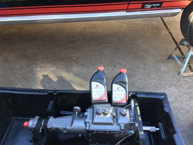

Recently I have done a lot of work on a 390GT Mustang that I have worked on for the past 30 years. It had a close ratio box with 3.50 rear gears. The owner two years ago paid David Kee about $2600 to exchange his close ratio small input box for a big in / big out wide ratio top loader. It’s a blast to drive now. The price included shipping both ways. Recently I swapped in a 462 CI stroker 428 in place of the 390. It has Vintage Air, PS, PB and it’s a black fast back with black interior.
