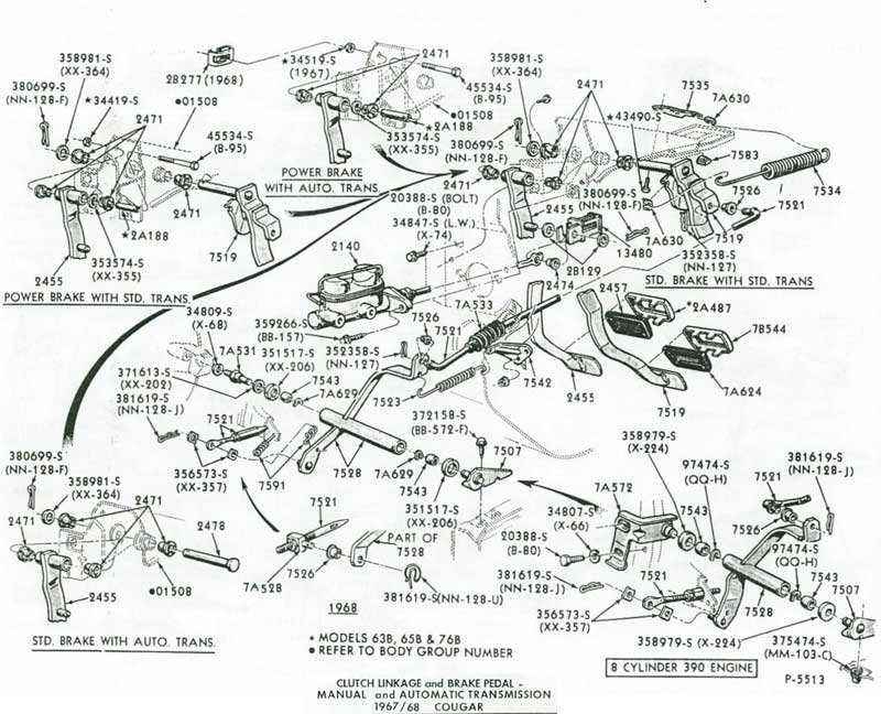

I am converting the car to a four speed, and have almost everything I need. I recently acquired the mount that goes on the engine bay side firewall but I’m not clear on which spring I need for that assembly. Is it this one?

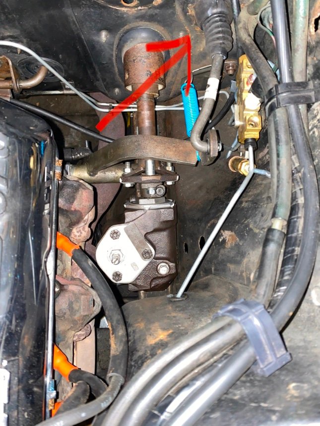

I think this is what your looking for.
No-I’m not looking for the one under the dash- #7523, that hooks to 7542 bracket
This one-
