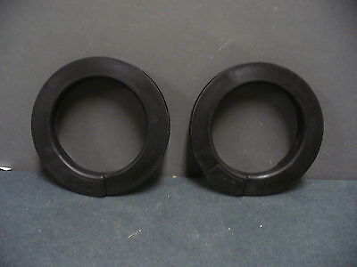

Stupid question. A few weeks ago I had replaced the upper and lower control arms on the driver side. The job is not finished yet as there is a few minor things that need be addressed so, it’s just patched up for now. The rubber isolator that went between the spring and shock tower was so brittle it easily broke apart. Want to go with rubber as it is the original material, if I cannot find the rubber type what are the thoughts on urethane?
I don’t think urethane in that location will give you any improved handling. Might add a couple squeaks to the suspension. Buy a sheet of good neoprene rubber. https://www.mcmaster.com/rubber-sheets/

I don’t know why. But, I was thinking rubber pads on the spring perches.
I have urethane upper spring insulators. They have been installed for several years and don’t squeak.
After considering the minimal effect these things have beyond spacing the coil spring off the stamped spring tower, I decided the argument is like picking which single malt Scotch to but your Cougar. I chose the inexpensive ones WCCC sells as “rubber,” which is no doubt synthetic something.

Rubber pads between the spring and spring perch is a service replacement thing. Originals did have them but later NOS/replacements did
I think Jeff meant to say that original perches did not have rubber between the lower perch and the spring. The later NOS D7 p/n ones did.
I had a set of rubber ones disintegrate in only a few years. I when back with polyurethane.
I don’t think urethane in that location will give you any improved handling. Might add a couple squeaks to the suspension. Buy a sheet of good neoprene rubber. McMaster-Carr
