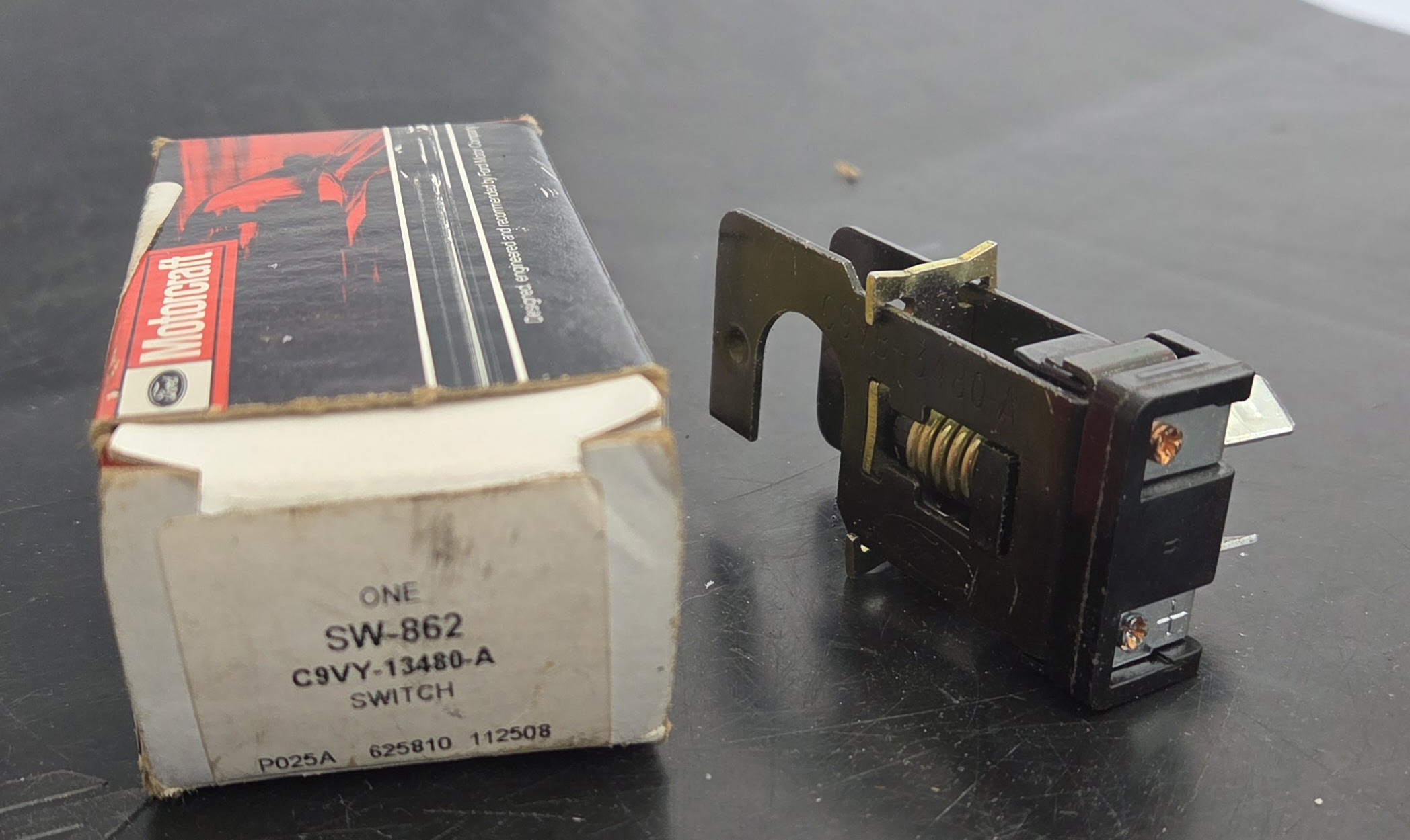

Brake lights were not functioning, so I went ahead and ordered an NOS brake light switch C9VY-13480-A (SW-862) off of eBay per Royce’s suggestion from one of his past posts.
It’s a pain getting your hand up in there to remove / replace the switch.
Brake lights now function.

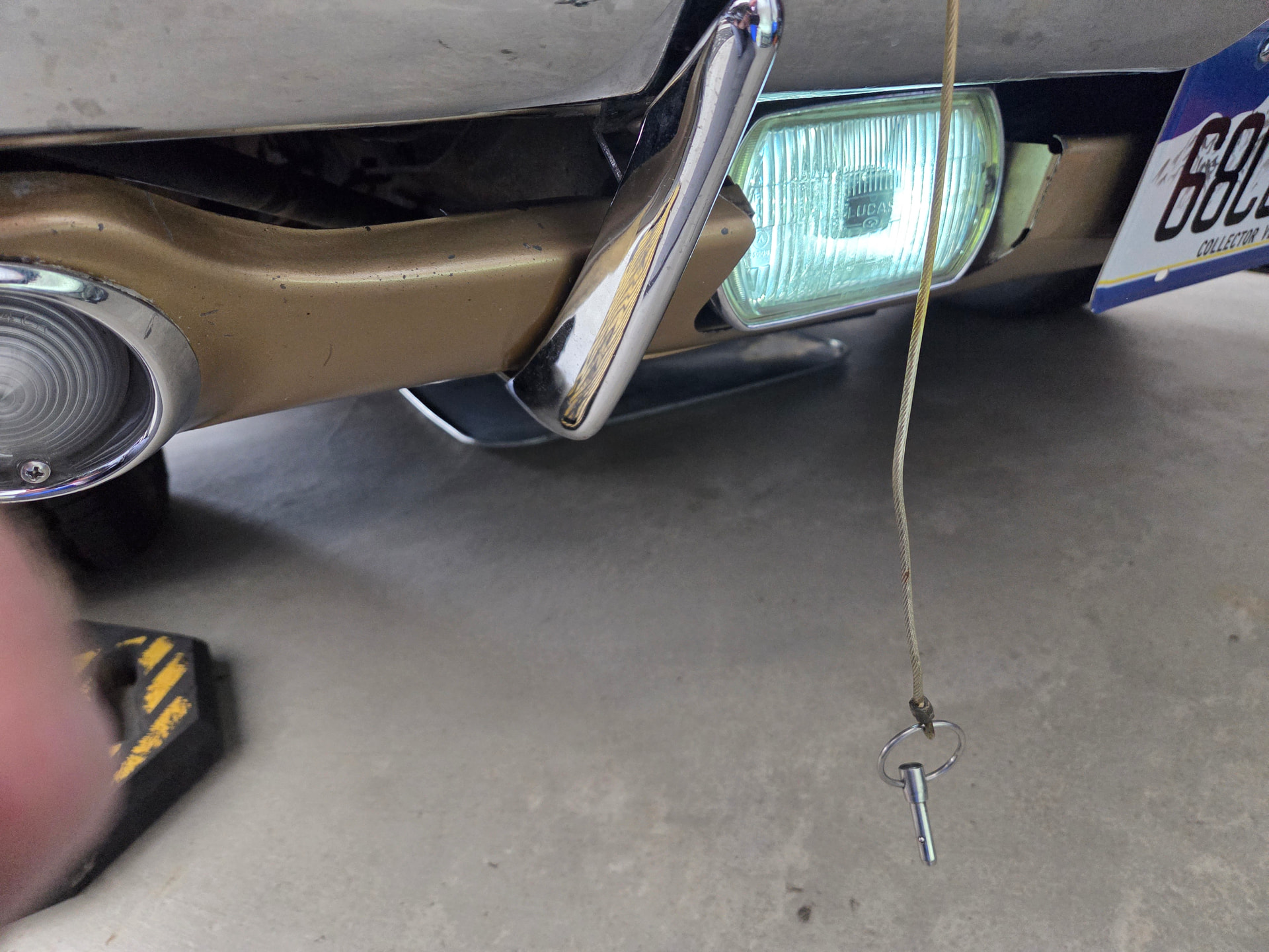

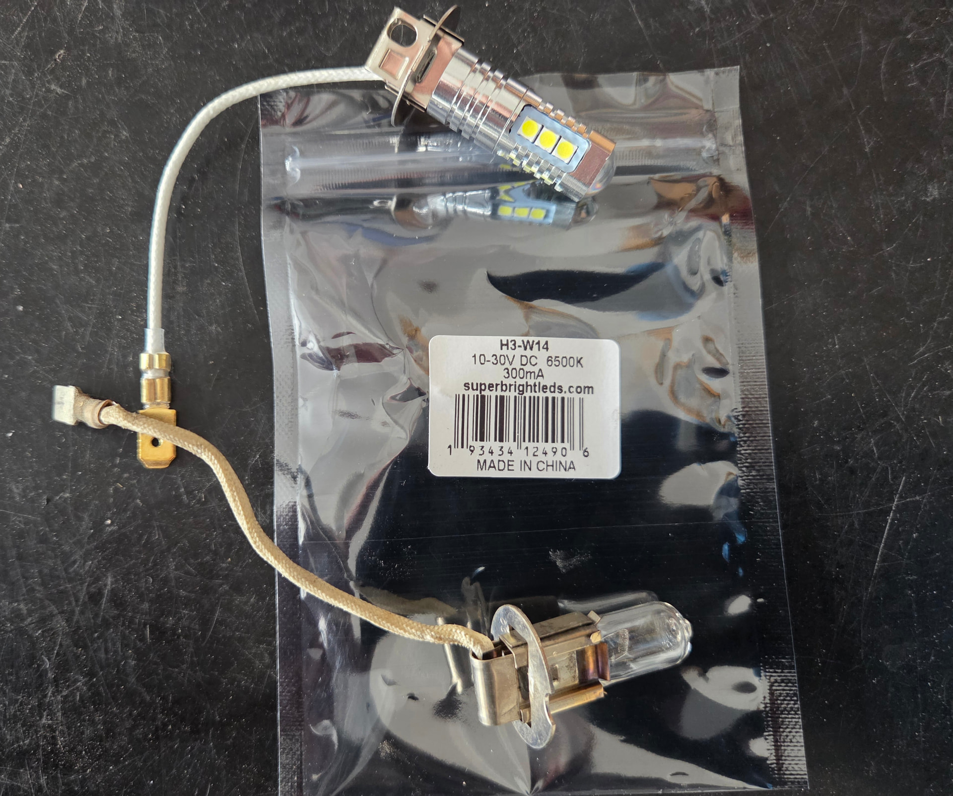

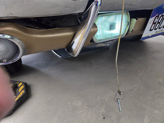

Installed the Lucas fog light H3 bulbs from halogen to LEDs to reduce the load on wiring and switch. They won’t be as bright as the halogens, but won’t be driving in poor weather anyways.
I was surprised to see the cardboard wire separator has survived.
Need to take it out some night to see they perform, along with the Octane LED headlights.

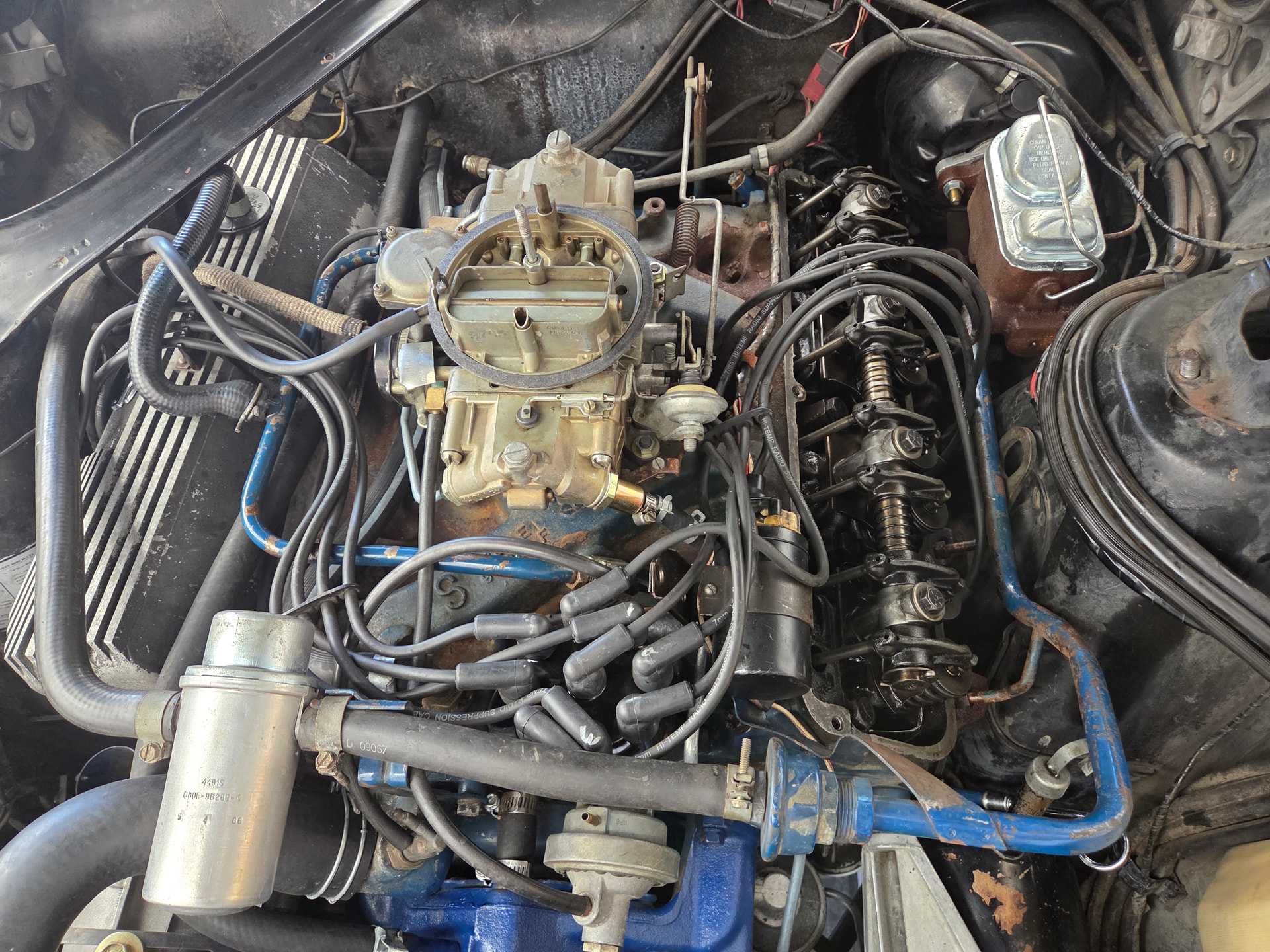

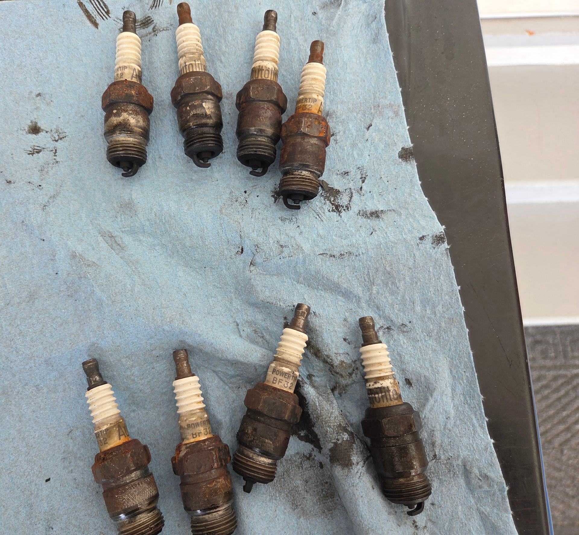

Changed the spark plugs today…that was a 4 hour job due to the air pump tubes and tall valve covers. I removed the valve covers and shock tower braces as I didn’t see any other way. After tackling plugs 1 - 4, 5 - 8 went much faster after relearning a few tricks.
I’m curious how old these plugs are…probably back to the original owner.

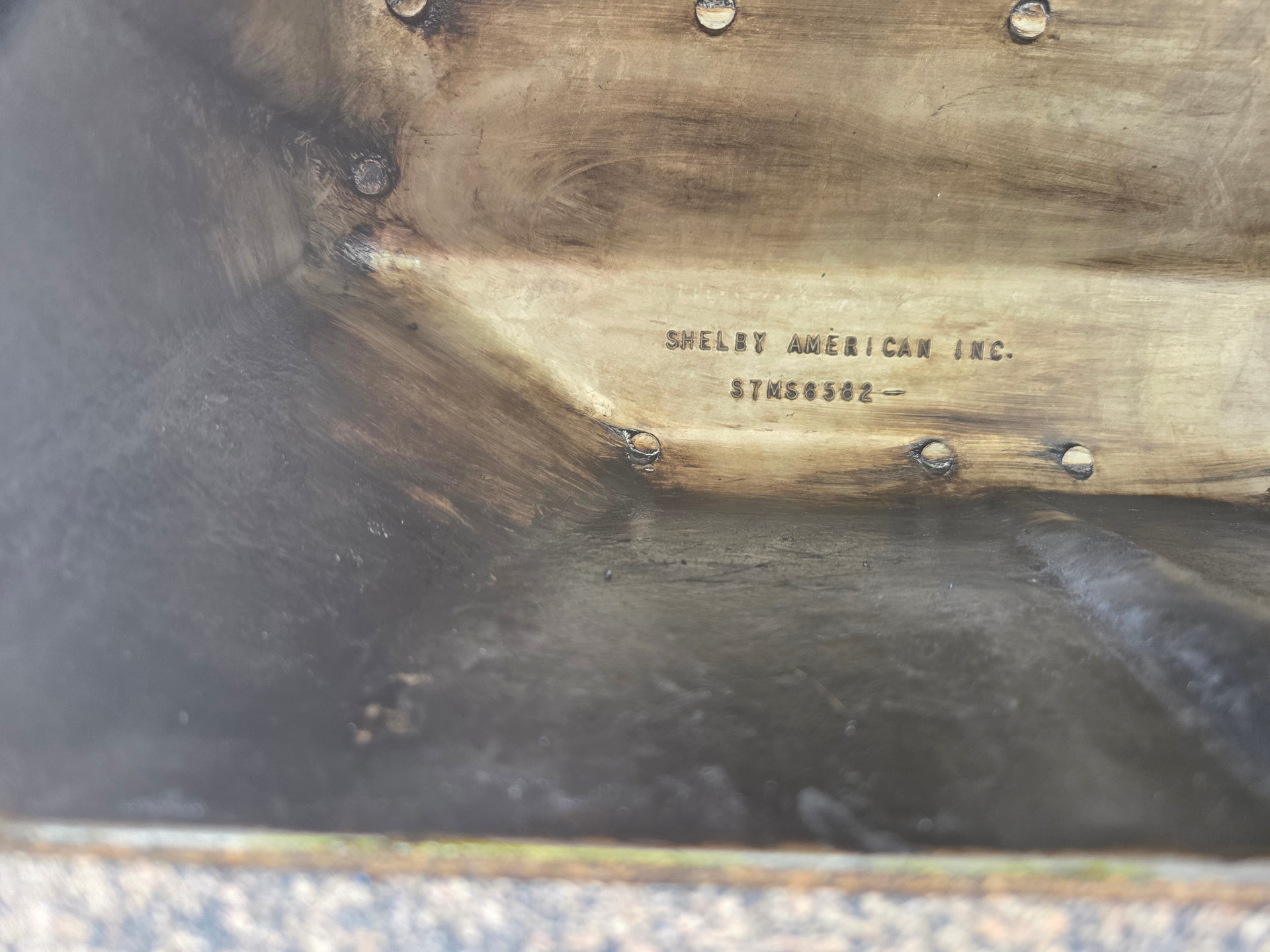

It was nice seeing the Shelby American stamping within the valve covers.

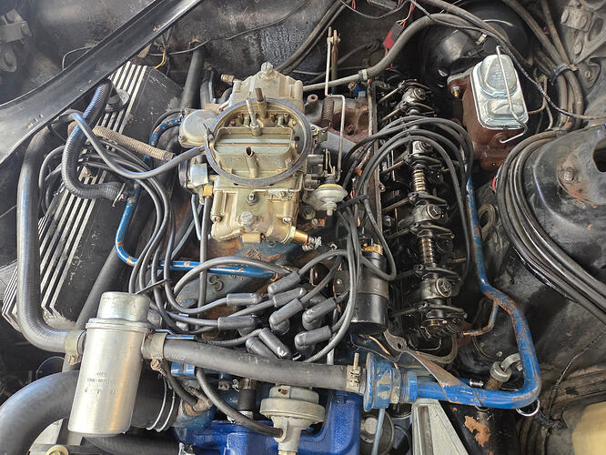

What’s the history on the carb? Just noticing that it has a dashpot and I thought manual cars didn’t have that? With this car being so original, if that is the original 3795-1 I may have to reassess mine.
I wondered the same thing when I spotted that dash pot, and can’t say for sure as some of that history is with original owner. I verified carb has correct metering blocks and date code.
I may just remove as it doesn’t appear to provide any value (mechanically or financial) unless I find otherwise.
This is really not the car to arbitrarily take parts off of. Most likely that was placed by the factory or perhaps a mechanic at a dealer used it to solve a drop throttle stalling issue. It might be out of adjustment or perhaps no longer working but it’s a part of the cars history.

I would think of that car like a time capsule to be preserved. Even those spark plugs could be original. If I were buying it, I would much prefer the original incandescent bulbs in sockets that hadn’t been opened up. Yeah, the LED’s perform better, but that car’s value is in its originality. Be sure you hang onto everything that you take off it!
Yes…all of the removed bulbs are in a baggy, and FoMoCo headlights in a box. One good thing in swapping bulbs was ability to clean any corroded contacts…that was mainly for the exterior.
I’ve learned over the years to keep original items.
