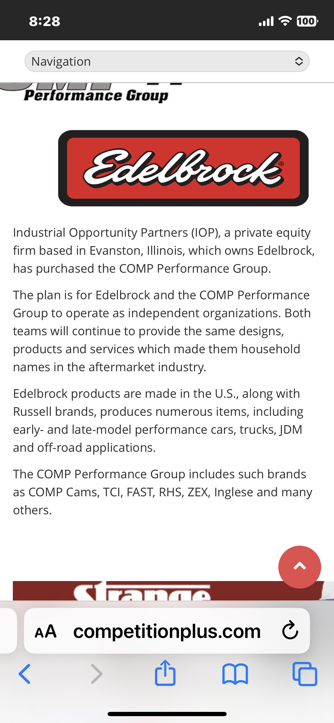

I am having my 69 351W rebuilt. I have an Edelbrock Performer intake manifold on my engine now, along with a Performer cam. I ordered an Edelbrock Performer cam and lifter kit from Summit. Inside the Edelbrock box is a box with Edelbrock lifters and a Comp Cams Camshaft. Cam specs appear to be the same.
My engine builder says Comp Cams are junk, made from inferior material.
Please let me know your opinions.
