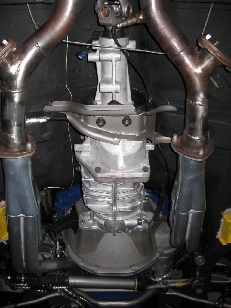

Are there pictures anywhere? I followed the link but did not see anything in the way of pictures (or a link to somewhere else that has some). May be that non-members cannot see some things, dunno. Would be interested in seeing what it looks like/consists of.
P.S. I could not make an aftermarket crossmember work, it put the tail of the trans too low and screwed up the trans/driveshaft angle, not to mention making it impossible for the exhaust to get up into the tunnel and clear the reinforcement plate (because I have a convertible).
I ended up modifying a FMX crossmember and it works awesome (with a TKO-600, that is what you have as well, correct?).
P.P.S. Here’s a pic (and check me out still being able to link to PB, they - knock on wood - still haven’t “worked their magic” on me!):
Unless he is making something new the crossmember is the brace under the engine (not transmission mount) that ties the shock towers together.

Oops, I’m totally off-base! Sorry about that. Tried to delete my post but cannot find an option to do that (is that a recent change?).
