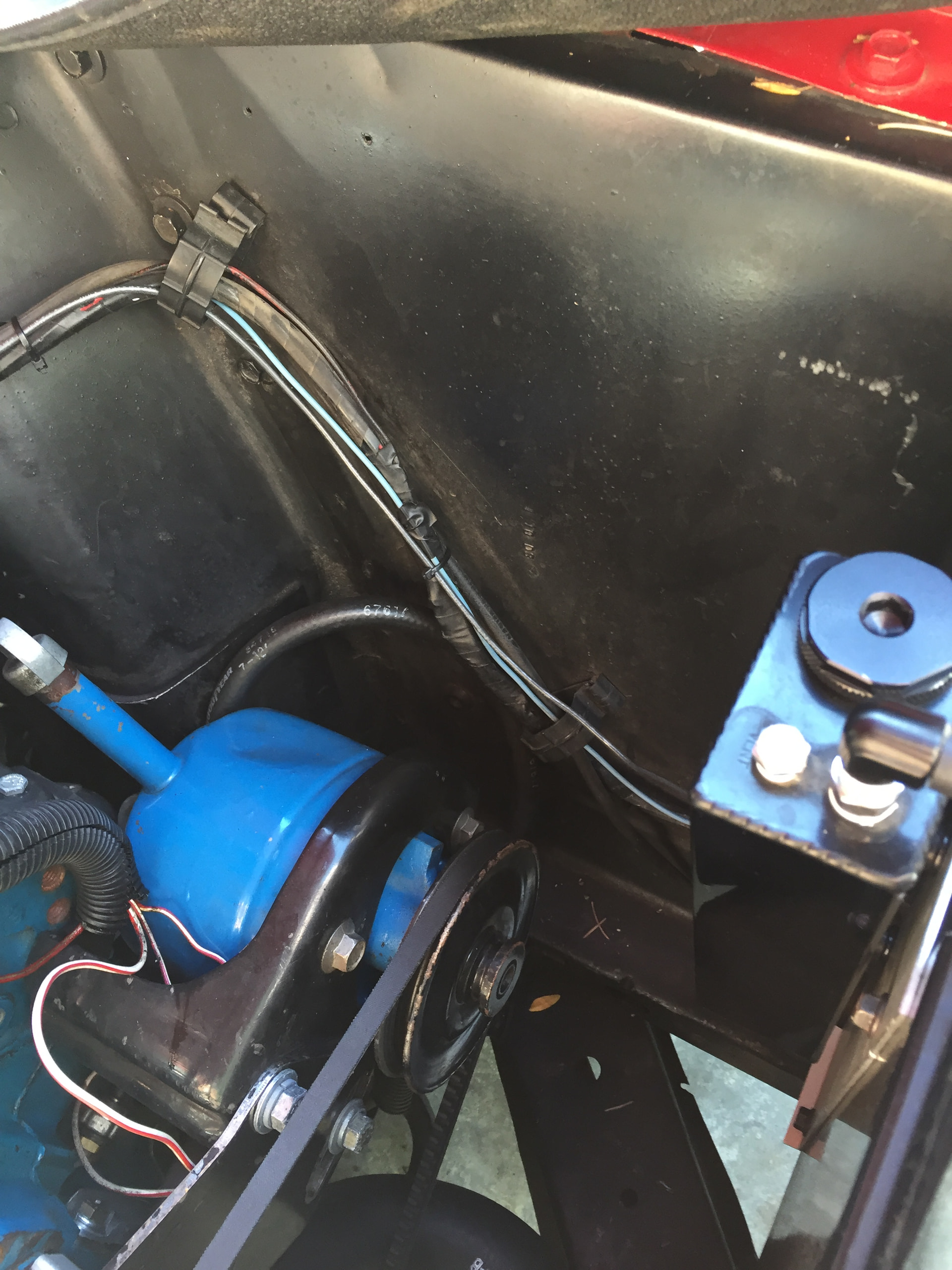

I used a Meziere recovery tank on my 1969. Let me see if I can find the pics.
I wanted a black tank and one that was rectangular. I mounted it to my electric fan shroud on the drivers side and added a bronze mesh breather and a black 90 deg hose barb fitting connected to the radiator neck.
