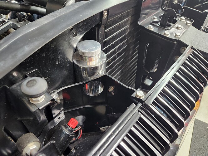

I use this and mount it on the backside of the radiator support. Peel off the sticker and it blends in surprisingly well
Thanks for the suggestions! I actually thought about repurposing another washer fluid tank, but I didn’t think I’d be able to get it to fit next to my existing one. The JAZ tank looks like it would fit nicely. I did notice my milk jug was close to half full at the highest point, so I may need to see if they have a 2 quart version.

I like this, This would blend in nicely under the hood for sure. Only down fall is not having a cap.
I have used the other styles posted here and they work nicely as well. Sometimes the caps can get stuck on them and they are kinda tall so fitting them in a cramped space is a challenge
