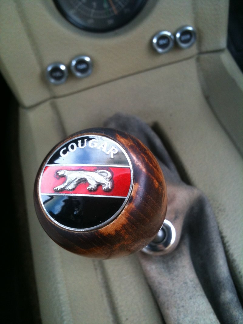

It’s been a long time since I’ve done any work on my faithful cat, so I spent some time sprucing up the interior. I picked up a cool emblem on ebay a while back and used it to replace my homemade emblem. It looks much better in real life- for some reason, my camera over-emphasizes the black smudges around the cat.
Sweet!
I think it looks great, it really pops with the black and the red!

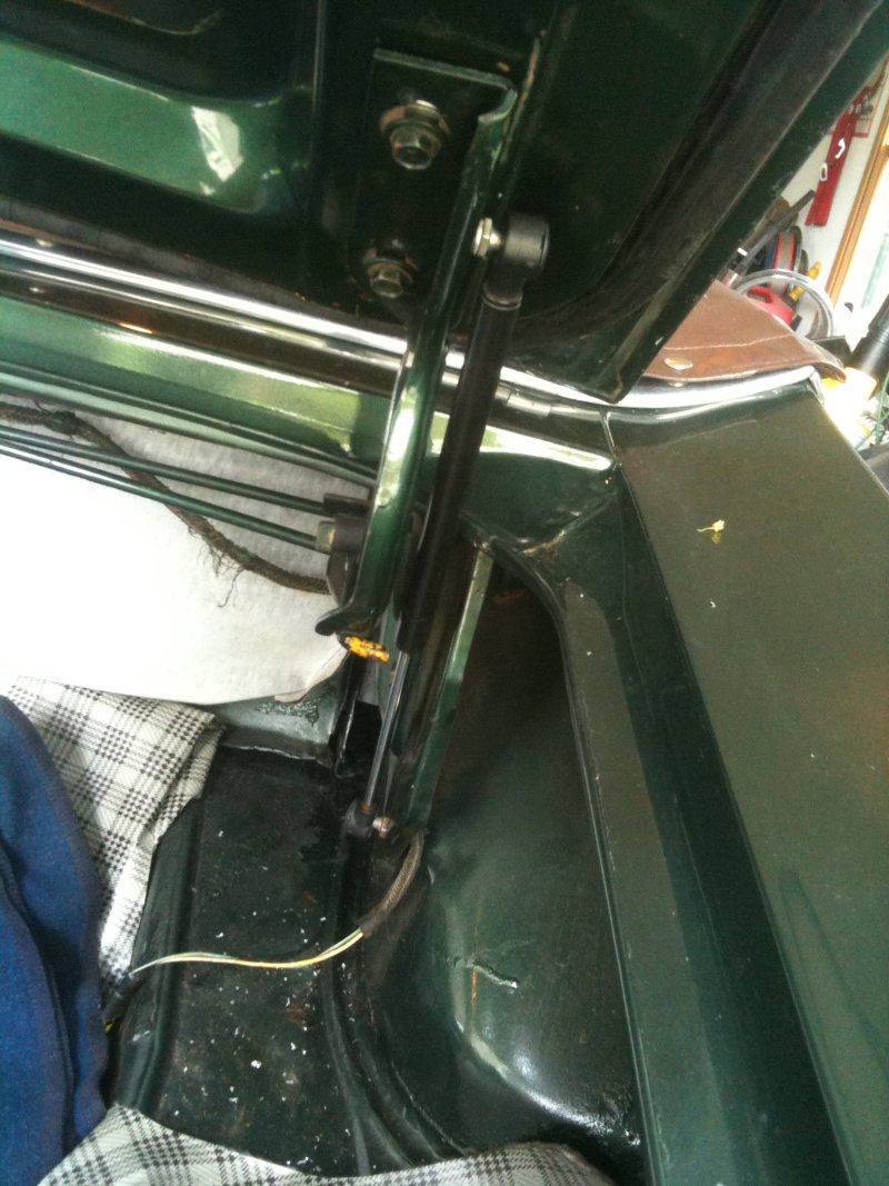

Here’s my latest cheapskate modification: gas struts for the trunk, salvaged from an old hot tub cover lift (including the nifty rectangular nut that looks like it was made to fit inside the Cougar hinge) . Price: $free. Time: finished before the grill was heated up for chicken. Result: my trunk now opens smoothly with no bouncing and I can add a luggage rack if the urge ever hits me to do so. No cutting was necessary, only a few 1/4" holes (2 per side). The struts fit tucked away neatly along side of the hinges so they don’t get in the way of anything.
Are you going to remove the springs?
They’re not really in the way and if I remove them, I’ll just have to find a place in the garage to store them. So, I think I’ll just leave them be.
Another neat modification Jody. :thumbup:

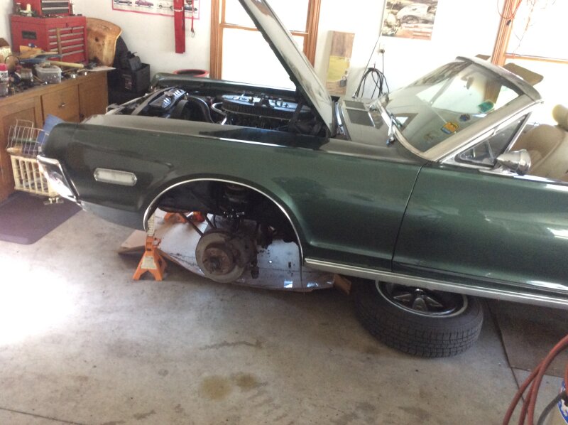

Well, what do you think? I was going to wait until spring to put these on, but I had to replace one of the tires anyway. One down, three to go.
I think the cougar rims look great. I like the wider spokes anyways.

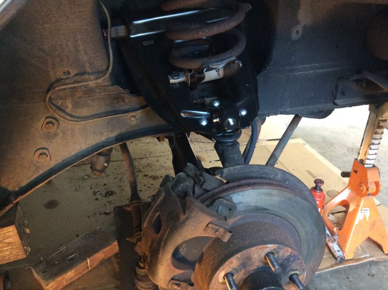

Nearing 170k miles on the clock and just got new tires so I figured it was probably a good time to rebuild the front suspension. New upper and lower arms/ball joints. Strut bushings were replaced only a few years back so I left them be.
I soaked everything with PB Blaster a few days ago which definitely helped, as did a homemade ball joint separator and a great big hammer. Everything came apart with minimal violence. While they were out, I took the opportunity to chop a half coil off the springs to give the front a little drop.
