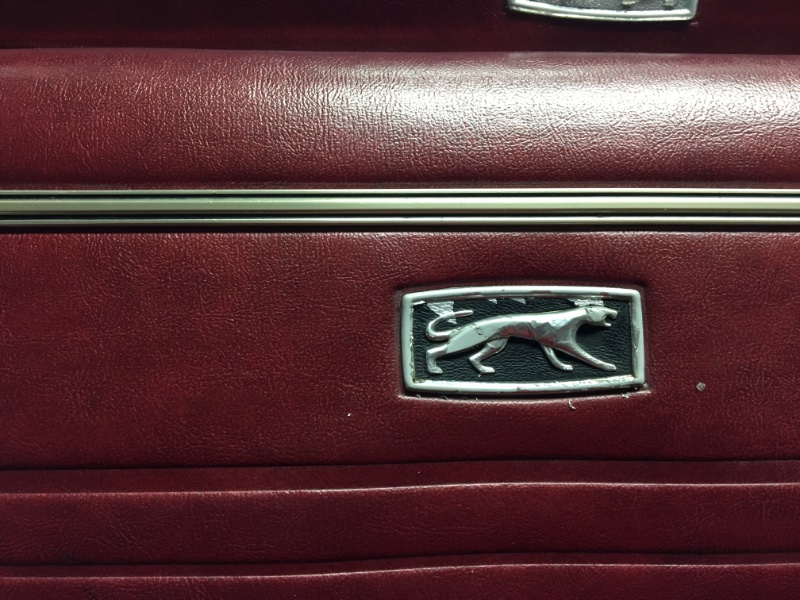

The foil on the cougar emblems on the interior door panels is peeling off. Has anyone ever replaced them or refinished them? I can’t imagine attempting to paint them by hand. They look really shoddy and I want them gleaming. Suggestions and advice please.

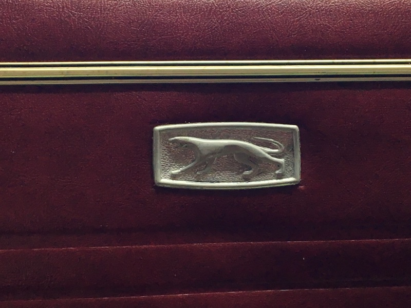

Try it on the one that is already void of it’s original chrome then paint the black background,I think you will like it.

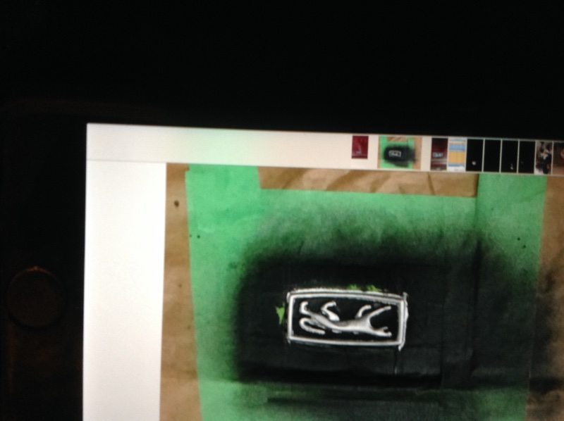

Great tips Cougarites, have a chrome pen coming from Seattle, plenty of great frogger tape for masking and can use a spray can for the black and then do the chrome after👍

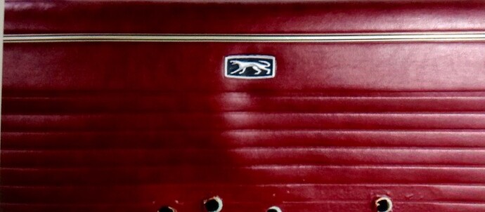

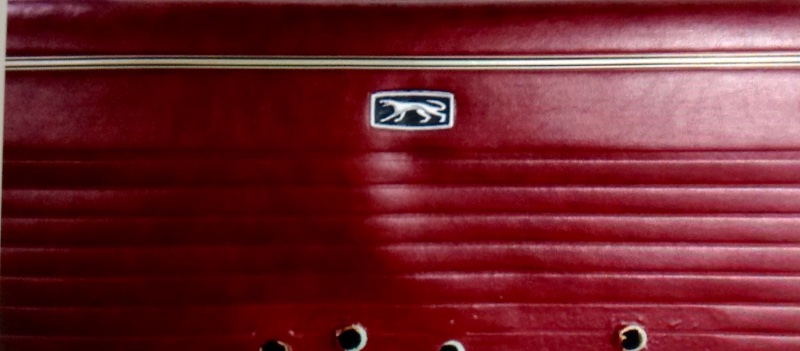

I opted to try a different method after all, I peeled, lightly scraped and gently sanded off all the black color and the chrome color. I used a 1mm fine artist paint brush and 2 types of paints. Both are oil based- Silver paint by Testor and Black/ Rustoleum Flat Black Plastic Paint. I also used Frogger Tape and masking paper. I would say it looks like an 8 out of 10. My car will never be entered in any car shows and unless you get a foot away it’s more than adequate. Once the door panels are redyed it will look even sharper.
Total cost $20
