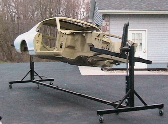

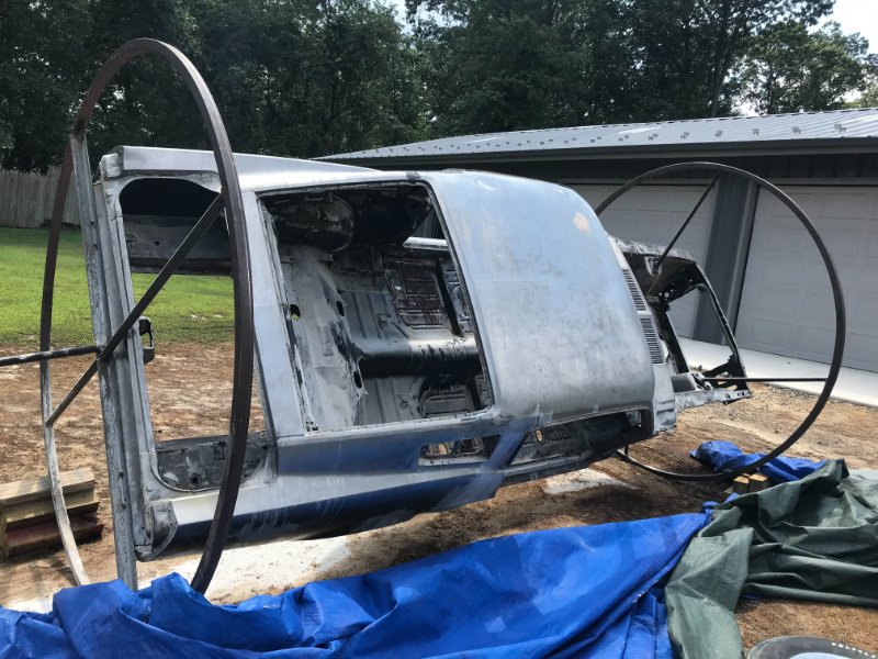

You could bild something like this for $350 in materials.
Pretty sure Brian Aust built one.

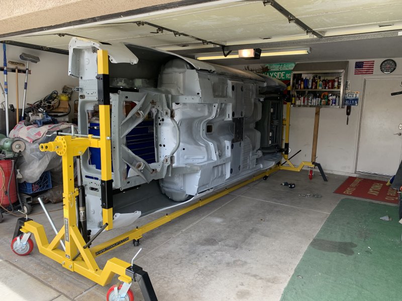

I was going to build one too, but I found the Titan ROT4500 for 1250 bucks delivered. Excellent build quality (in my opinion) rolls easy and it actually fits in my garage.

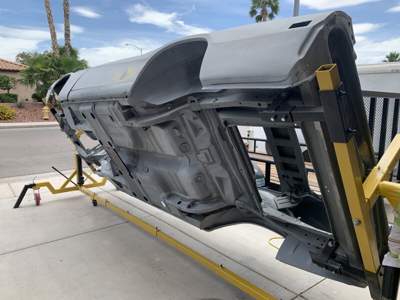

Make sure you get the hydraulic jacks if you don’t have a lift for mounting the body on the rotisserie. The only up grade I need to do to mine is larger caster wheels so it rolls easier over uneven surfaces.

That is one pretty piece of equipment right there. Very nice.

Damn! Now I feel like I paid too much!! I’m spoiled by how easy it is flip it over and work on the bottom side!
