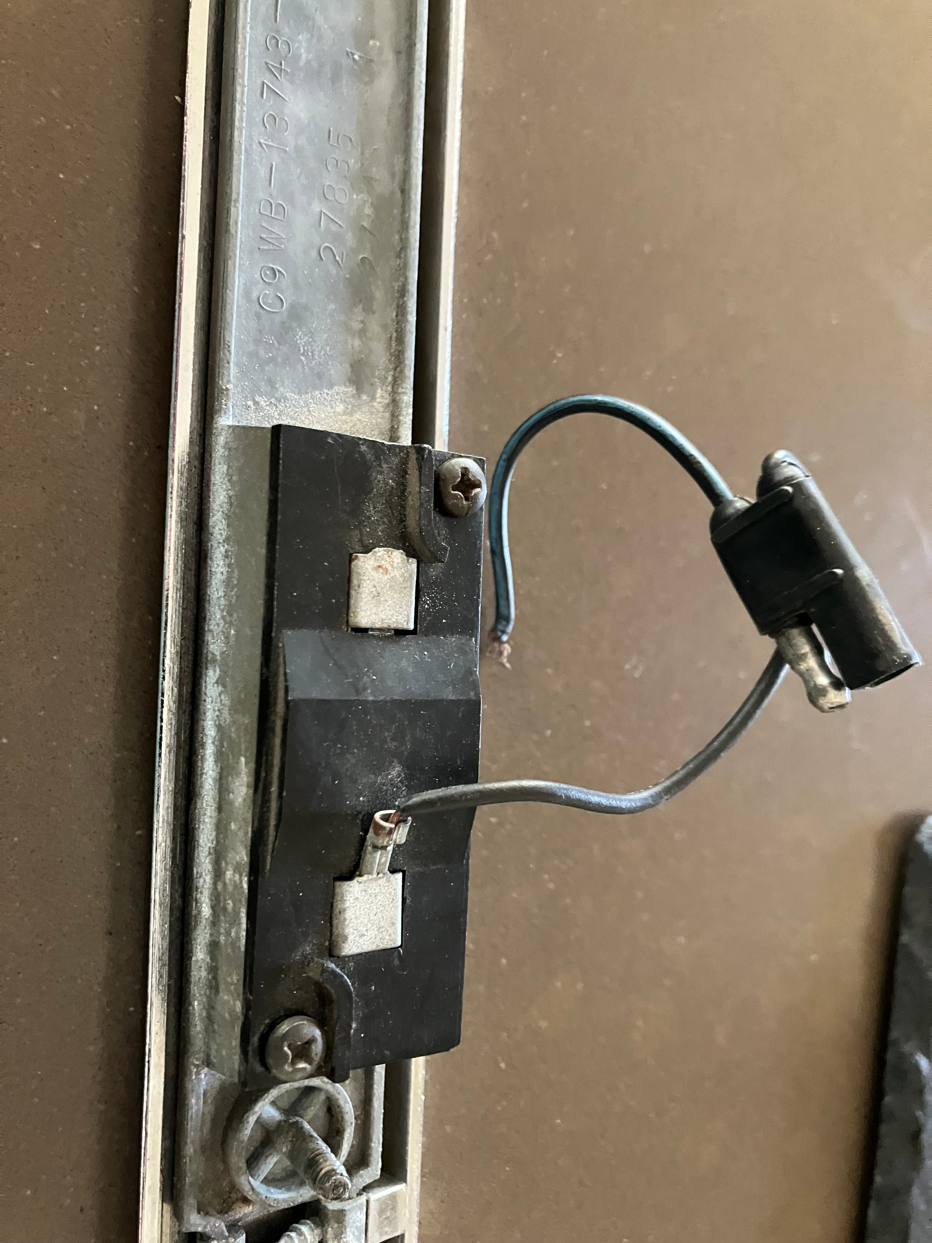

My Courtesy Door Light lead broke. Can a replacement connecter/bulb holder be obtained or do I need to solder the wire to the bulb holder plate?
How does the chrome look on the other side? If it is pitted, the repros are pretty decent. If the chrome is great, Grade B entire assemblies used on WCCC website run 26-32 bucks depending which side. Or just solder it and nobody will know different.
