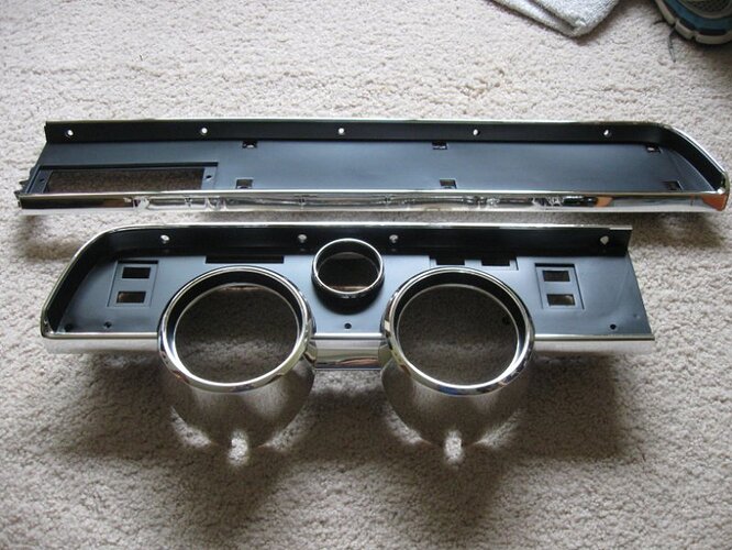

I used Vacuum Orna-Metal in Michigan earlier this year for the dash on my 67. Not necessarily the least expensive, but they did a fantastic job. They can do some minor repairs to the bezel too if needed.
www.vacuumorna-metal.com.

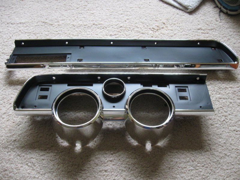

In the past three years I had one set done by Instrument Specialties and another set done by Vacuum Orna Metal.
The set done by Vacuum Orna Metal took three months less time. The set sent to Vacuum Orna Metal was less expensive by $200. Both companies have excellent quality and communications.
2nd for Vacuum Ornametal. Reasonable price and great quality.
I also used Vacuum Orna-Metal for the same reasons - better price and turnaround time. Very happy with the quality. Also used them for some smaller plastic chrome items like the steering wheel center emblem and AC vent border.

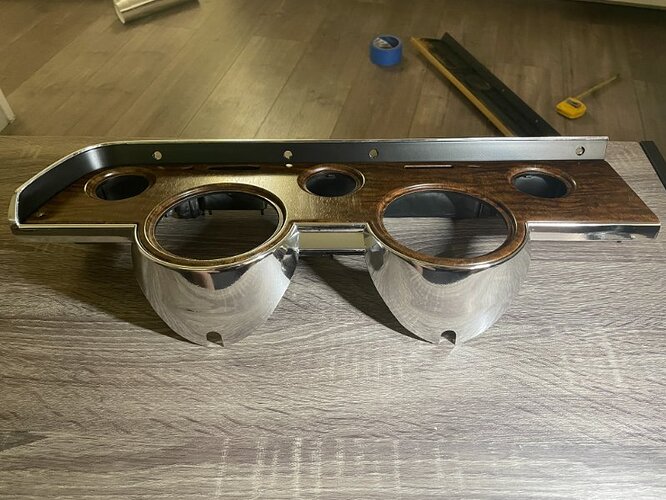

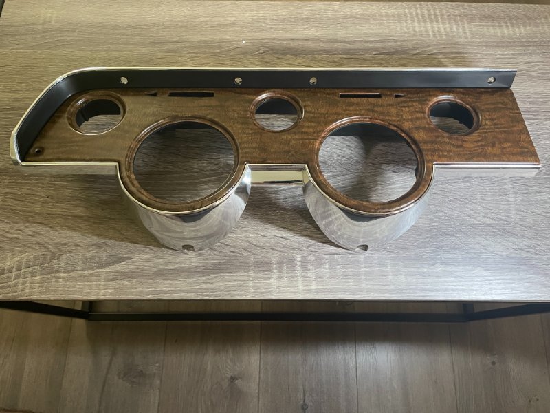

I know you were asking for recommendations for vacuum metalizing, but in case you are considering alternatives…
I finished wrapping my Bezel with chrome vinyl last night. Think it came out pretty darn clean for $20 worth of material. A few blemishes here and there but nothing noticeable.

It’s a bit different than your traditional wrap in that it actually has an adhesive backing. It can be heated and stretched slightly which makes it easy to work over the curves. Another member on the forum had used chrome vinyl wrap and apparently it has held up very well.

Tip: You’ll want to cut the film in multiple sections rather than try to wrap it all with one piece. For reference, on my cluster the wrap took a total of 6 pieces, cut at the seams and corners so they are not visible.
