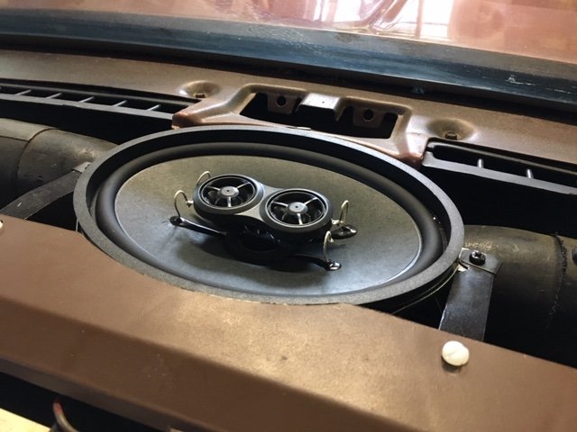

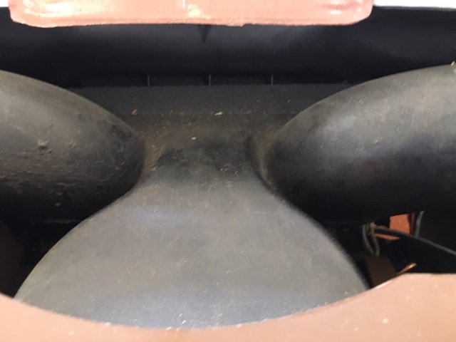

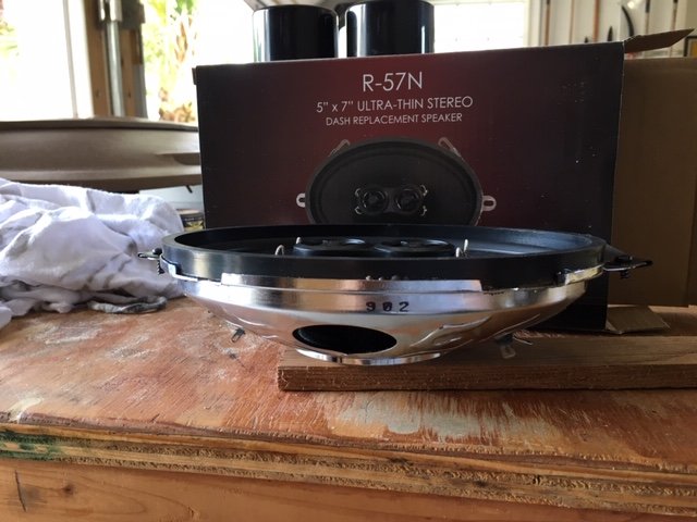

Extremely limited clearance. Less than 2" depth at center of opening. Ford anticipated a 5 x 7 speaker here but filled the location with hard duct work for the AC and defrosters. Ordered RetroSound R-57N speaker that is dual tweeter with single cone and less than 2" deep. Will have to fabricate bracket to install. Will take photos and post here when done.
Bottom line: Easy to remove dash panel but tough to fit speaker.
Used 11381 from WCCC,
JUST fitted snuggly were it should, sounds ok ,
looked like it was going to foul the warning lamp bezel but screwed in JUST right.

With 2" height, there is no cone magnet speaker that will work in '73 with factory AC. Installed Retrosound 57-N.
