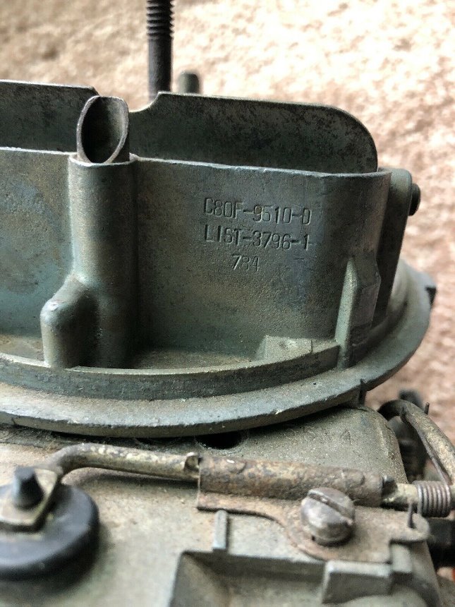

After searching for 15 seconds here’s one for sale at a very reasonable price:
https://www.ebay.com/itm/1968-HOLLEY-LIST-3796-1-C80F-9510-D-Dated-814-MUSTANG-TORINO-FAIRLANE-390/153488673644?epid=1540597042&hash=item23bca34b6c:g:l-kAAOSwPKZc2rnG

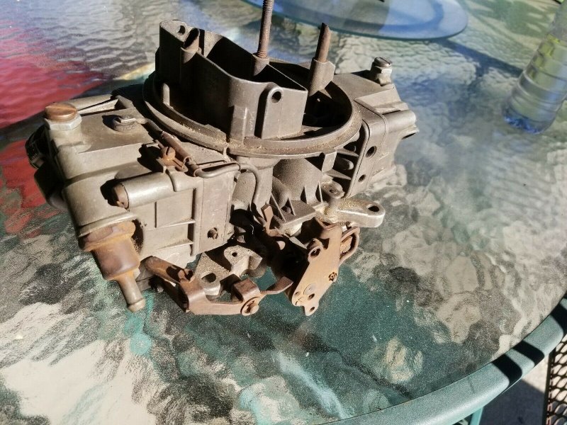

Another 30 seconds of searching finds an even better one:
https://www.ebay.com/itm/1968-Original-Ford-Mustang-Cougar-390-Automatic-Holley-Carburetor-C8OF-9510-D/323836083638?epid=1123653719&hash=item4b66227db6:g:wfMAAOSwPqRdBpJk
Just confirming that you have an automatic transmission in your car.
Some Holleys were built in batches so this makes dates somewhat limited and this can affect the time gap. In general (without know if they were batch built) typically the difference from the cars real build date is 1-3 months but of course the date should really be compared to the engine assemble date to be more exact

Agree, I’ve seen carb dates as far ahead as six months and be correct.
