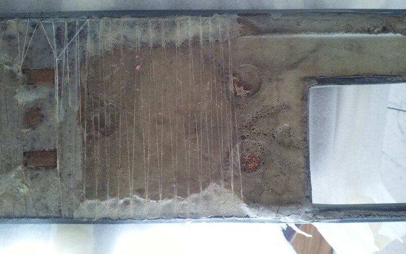

On the console pads I actually fixed my 4-speed one that was separating from the metal by stitching from side to side through that little bit that folds around the metal. I used a heavy fishing line and a curved needle. After I got it stitched up I covered all the line and stitch holes with a thin coat of vinyl adhesive. I got it warm over the heat vent in the house first before I did it do the vinyl was pliable enough. Its held up for a few years already. Keeping my eye out for a better pad someday.

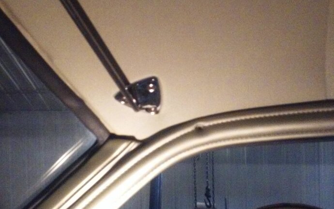

I was afraid there would be large gaps if i changed to the regular windlace. I will find a picture of the droop and post it. Its the passenger door so I see it all the time. I took a picture of my nephew in the car and you see this blob hanging down. It makes me cringe.I would not have thought you could get a light color on black but it looks good. I have more options now, Thanks!

I decided not to post the picture after seeing an ocean of waves in my headliner. It is blue after all. But it tells me that the headliner was redone and the windlace was just installed improperly. Add that to my list; seat cover, console, windlace, headliner and vinyl top. That should be good for this winter’s interior work.
Ignore the garage in the background. The bulge is worse when seen from outside the car.
