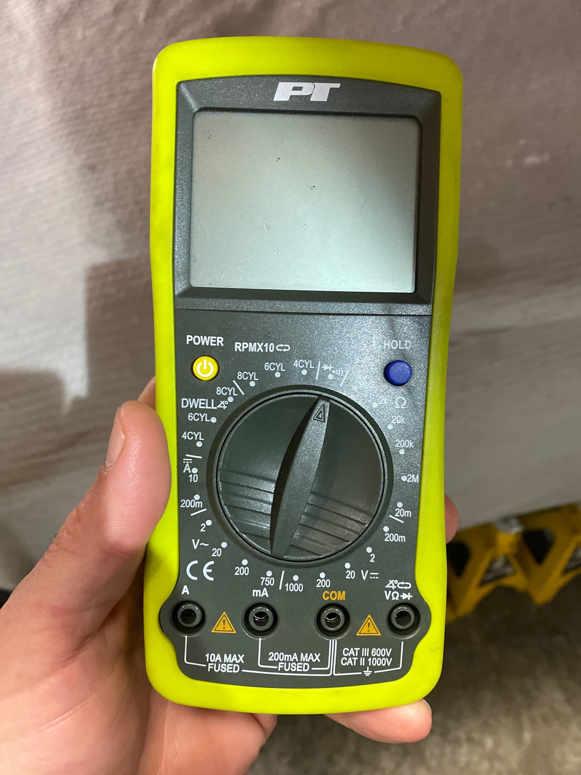

I got this multi-meter at O’Reillys. It has worked well and has tach and dwell functions.
