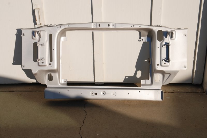

:think: I finally am getting around to installing some new sheet metal in the engine compartment. Opened up the box containing my new radiator support and SUPRISE, its silver. I’ve never had a part with this finish on it so I figured i would refer to the knowledge base here on CCC for suggestions. I am wondering what anyone who has already dealt with this finish did with it.
Scuff it and paint with epoxy primer and underhood paint.
Strip it and compleetly re-paint it
Paint right over this coating
Any other options?

I’ve seen this finish on their parts before, I believe it’s a weld-through primer. Mainly to protect the metal from corrosion and make it easy to weld in. I think you can paint right over it, but I’m sure others here have experience with it and can say for sure.
Send an e-mail to Dynacorn with that picture and ask what finish is on the part. That way you’re not guessing what to do next.
