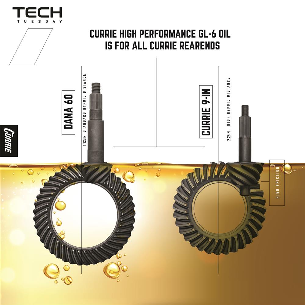

The 9-Inch Gear Is Unique
The design of the 9-inch features a high-offset distance that places the center-line of the pinion gear 2.25-inches below the center-line of the ring gear, which is substantial when compared to the 1.125 to 1.5-inch offsets of other gear sets (see image below). The high-offset distance increases the contact patch between the ring and pinion teeth by approximately 30-percent and is a crucial reason for the legendary strength of the 9-inch gears. However, strength comes at a price, as this high-offset distance creates increased sliding friction and heat across the gear tooth face. Because of this, not using high-shear oil such as Currie’s 85/140w can lead to scoring and certain gear death, especially during extreme scenarios such as off-roading and racing. The increased pressure capabilities and wear resistance found in Currie’s GL-6 rated gear oils are designed with all this in mind to ensure your rearend’s gears and bearings are adequately protected under the most severe conditions.
Pinion offset distance compared

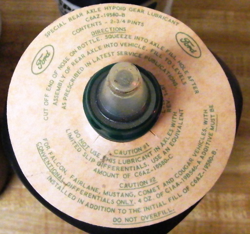

I’ve never bought anything from Currie. All my Ford 9" rears use this:
DSCF2840

I have bought it online for years. Like gah says it is easily found everywhere and anywhere. Not sure what your Ford dealer’s problem is - maybe a clueless guy that you talked to? Certainly the dealer rebuilds rear ends every week - what do they use?
Yes, I found that one as well, and NPD is in my neck o’ the woods so no shipping.
ROYCE: They use their present day gear oil, which he had to physically check to tell me it was hypoid; I don’t know the part # however. I was just commenting on the bottle you showed in the post, that looks like “old school”.
It is a label picture that I kept after using the oil inside but the part number is currently available so I do not know what is wrong with your Ford dealer.
