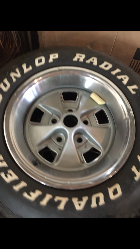

Wheel question
  1. My cougar is a ‘67 but the wheels I plan on using came off a ‘68 mustang. How can I tell if they were for disc or drum originally? Or Is there a measurement I can take to make sure they will fit.
    Thanks!
    Mark
Again, ALL 1968 Mustang / Cougar wheels work with either disc or drum brakes.
In your photo you show what appears to be a 1967 Cougar styled steel wheel. That wheel will not fit single piston calipers.

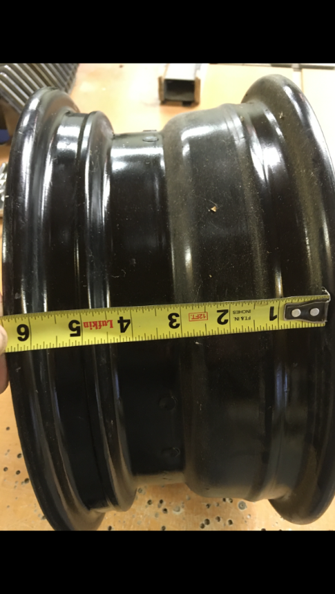

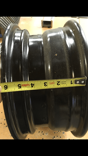

Oh Geeze. Plenty to try to sort out I guess.
Now I need to figure out if they are ‘67 or ‘68. Ia there stamping on the wheel or measuments that would tell me?
Seller was old Timer gear head Said he pulled them off his ‘68 mustang?
Mark
Easy way would be to try one of those wheels on a 68 - 73 Mustang / Cougar / Comet / Fairlane with front disc brakes. If you have one with no tire the 1968 and later wheels are at least 6" inside the rim. 1967 wheels are 5 1/2".
Think I’m good?

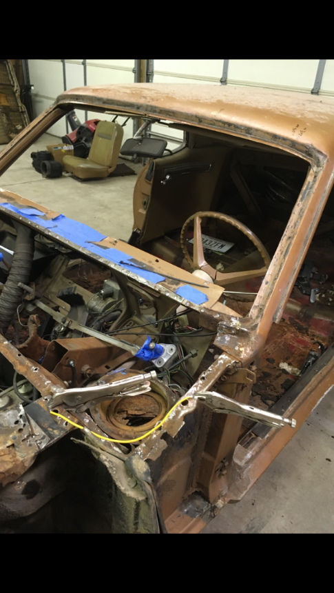

Mark, Good job with the cowl removal, one question, what is the yellow wire for, some kind of ground?
Yes that was a temp ground. Previous owner installed a new fuse block and hacked it in with wire nuts and only left 1” coming out of the block. I cut all that out and soldered new wires to back of fuse block. Amazing how much easier things are to get do with the cowl off. Anyway. Had to clean that up and then in testing turn signals and such found they we’re acting up from the weak ground after fender extension to cowl was removed.
This was just a temp jumper.
