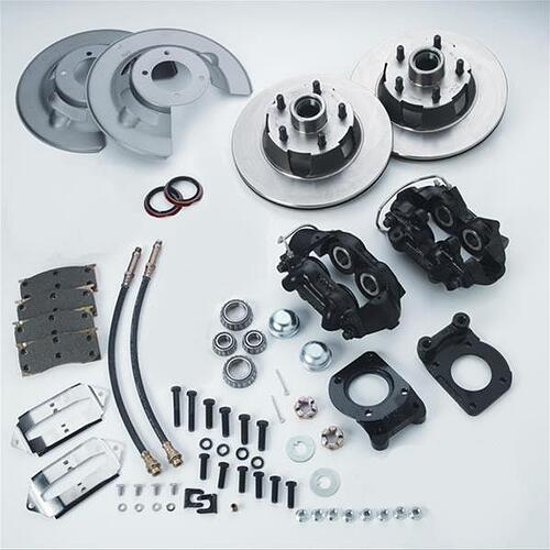

The brakes on my car started out as manual drums and I converted to the '67 style Kelsey-Hayes 4-piston brakes. They are typically not the first choice for a conversion, as leaking seems to be a common theme. The front spindles are the same for the '67 (and '68) drums and for discs in '67, so with the K-H setup you don’t have to change spindles. My initial switch over used calipers and mounts from a '67 390 car, which just bolted on with no other modification. I ended up getting new Stainless Steel Brake Co. front calipers and haven’t had any issues with them to this point, but they’ve only been on for well less than a year. I think quite a few other conversions will require newer spindles, which isn’t necessarily a bad deal. One other thing to consider is whether you currently have power or manual brakes. The brake pedal is different (for leverage) depending on whether it’s power or manual. Mine was manual, so I stayed with manual brakes. Manual discs were never an option on Cougars, so I had to piece things together a bit. My master cylinder is designed for a mid-70’s Maverick and I installed a manual proportioning valve in the rear brake line. I also had to adjust the pushrod length between the pedal and MC. I’ve been relatively pleased with the braking performance. I can lock all 4 tires up if I try hard enough. Power brakes would obviously make it easier, but it adds a fair amount of complexity.

The original Kelsey-Hayes style 4 piston front brakes work great. A lot of companies sell kits for those at very reasonable prices, and include everything from the proportioning valve to the proper master cylinder for this.
They work with stock drum spindles just fine, so you don’t have to mess around with tie rod ends and all that nonsense either. When I converted my car to the Granada front spindles, there were not as many options available. IMHO, it’s pointless to go to the big single-piston setups, as they require either bracket fabrication or different spindles, and they generally don’t work quite as well as the earlier setup. Going with the K/H brakes means no issues with bumpsteer or Ackermann angle problems on your car, since you are using essentially original type equipment.

The kit from Stainless Steel brakes is a bolt on using your original spindles. That’s the easiest and cheapest way I think.

I installed one of their kits maybe 15 years ago. It was great.
Diskbrakeswap.com (CSRP) sells a Granada conversion for a reasonable price. Their kit includes everything you need for the swap. Great customer service. You can get loaded calipers from them for less than the cost of pads.
I have the SSBC Kit on my 69, it has been great
