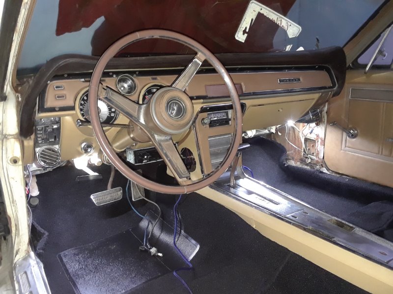

just fixed the turn signal switch/ cam canceling part in my 1967 cougar, standard column… not sure if I plugged all the wires correctly . after I did this repair, my battery keeps dying. no aftermarket stereo, brand new battery, brand new 1 wire alternator . when I take the terminals off the battery and place them back on the battery, I hear the possible sound of a relay activate under the dash, driver side. if anyone could help, I would greatly appreciate the help
