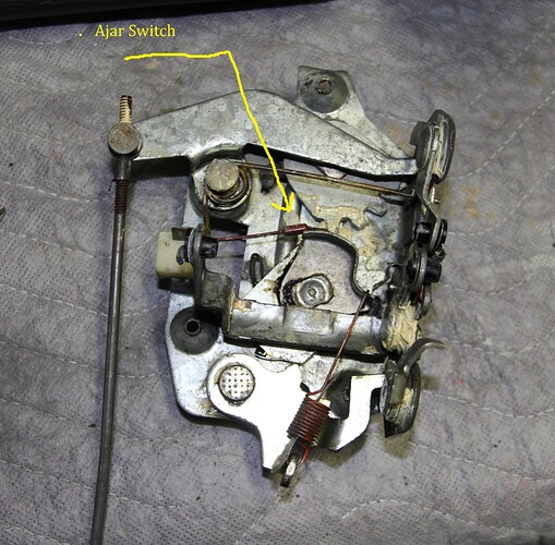

Does anyone have an image of the Door Ajar Switch correctly mounted. My grounding arm is mounted under the cam - I believe it is supposed to be above the cam. Thus, my door ajar light stays on when the doors are closed and shuts off when they are open.
Not a very good pic, but you can sorta see the door ajar switch on my 70.
Thank you Calicat. I figured it out. Both switches were definitely mounted wrong. I took a photo. I will add it to the thread.
Awesome - it’s always nice when what you think is wrong is actually the problem, and you can fix it!

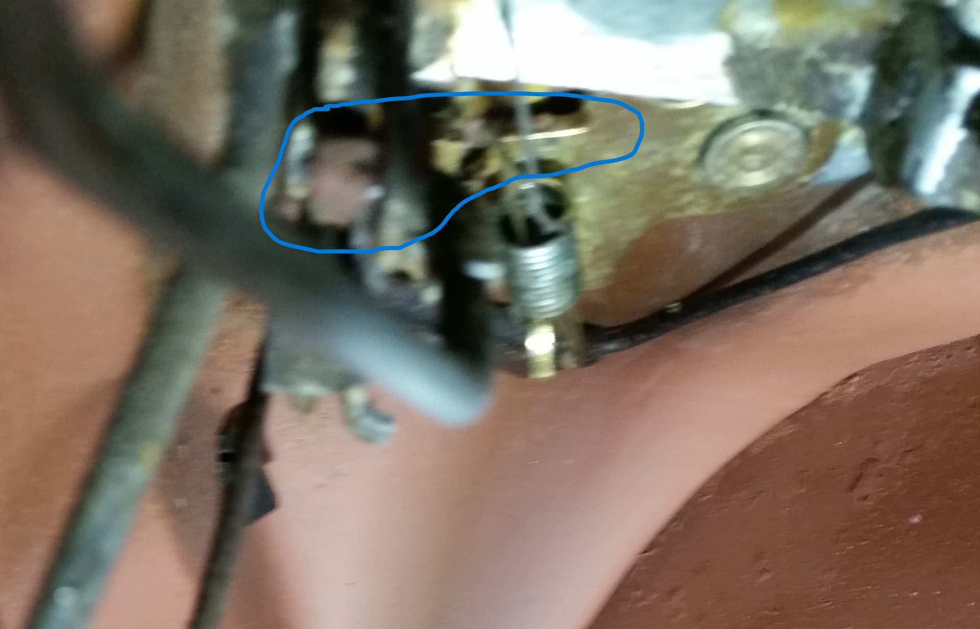

Here is a photo of the switch arm properly mounted.
The contact cam and the follow arm should be sanded/lightly filed to keep dirt, corrosion, and rust from breaking the contact. Will be a yearly maintenance item I suspect.
