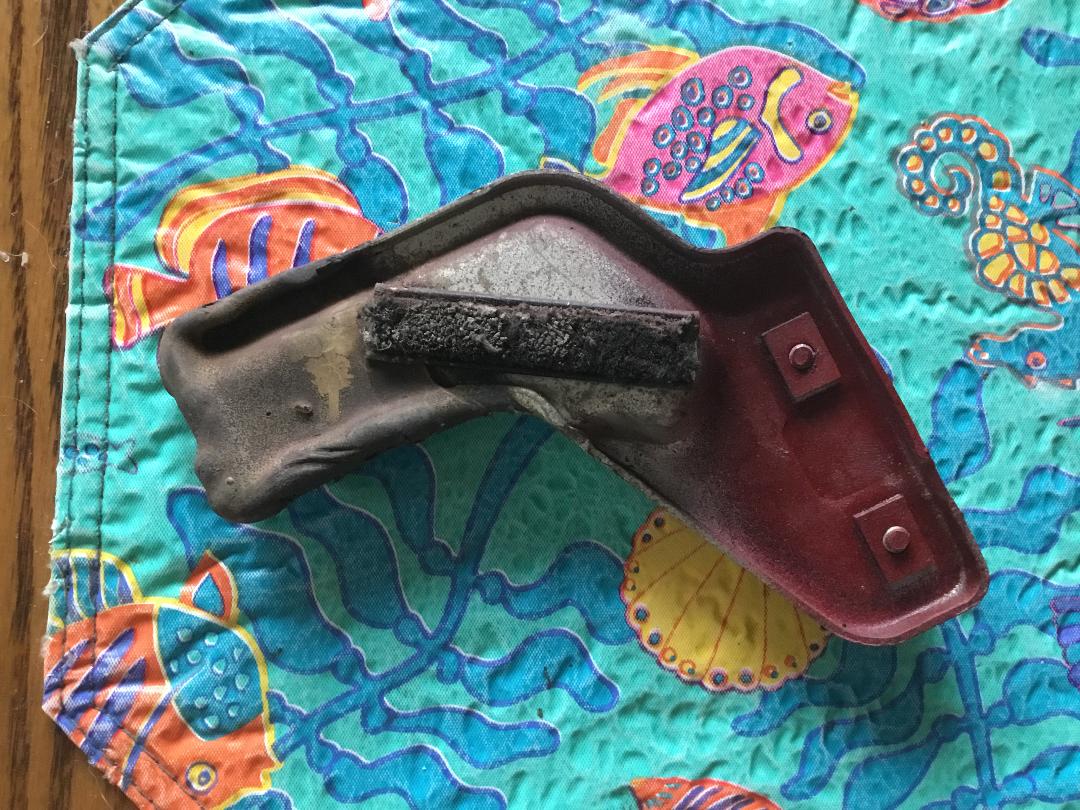

on the rear door window stop , there is a felt guide (stabalizer) that rides on the glass . mine is rock hard and is starting to scratch the glass . does anyone know if this felt can be bought separately , and what is it called ? i looked on the internet and the whole stop for sale . the only problem is the felt on the used ones doesn’t look to be in that gooda shape .

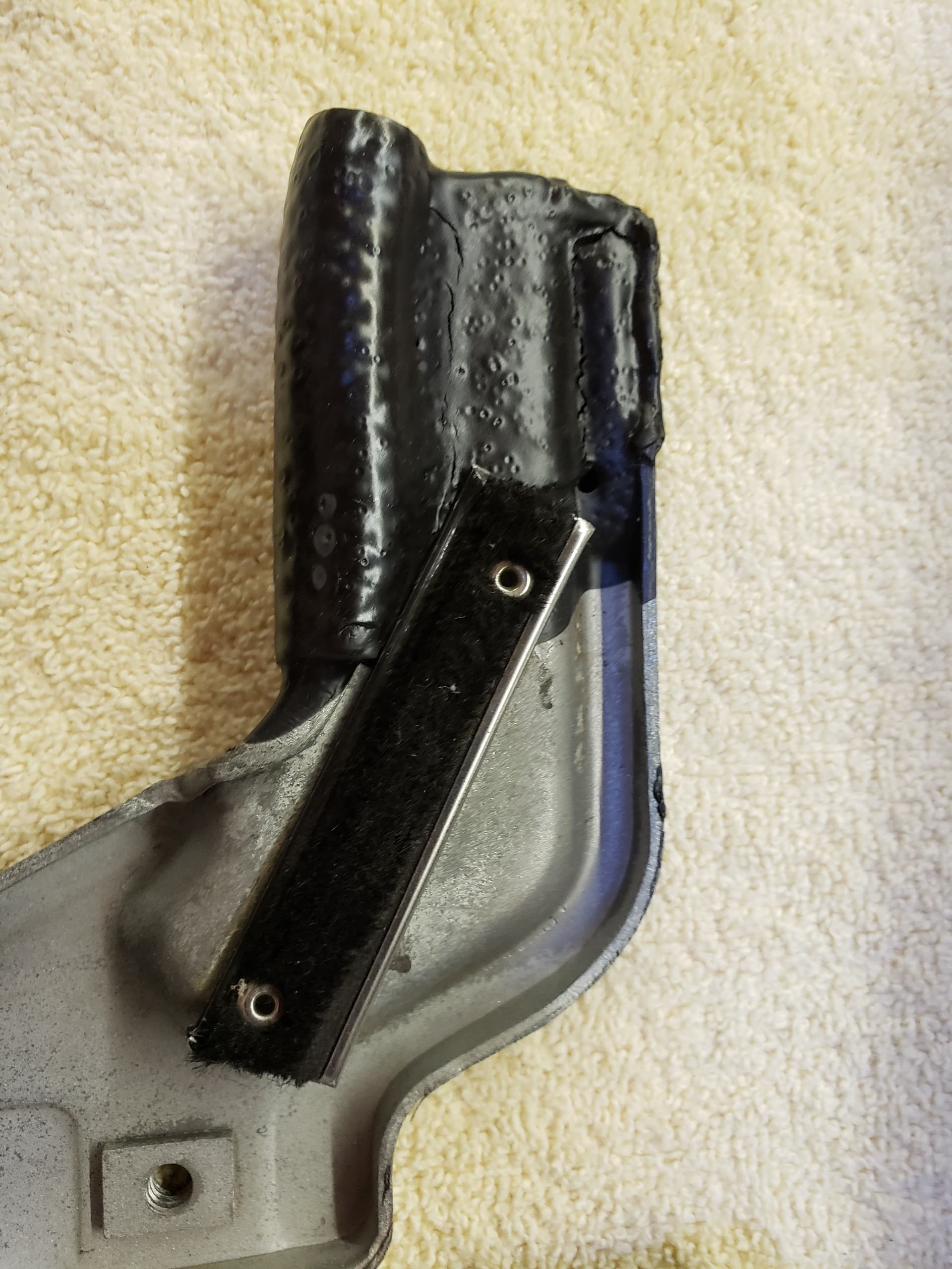

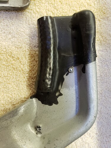

I use beltline W/X .It is almost a exact replacement. Drill out old rivets & drill new ones. Rivet back on.I also use a piece of fuel line hose split & put over the old rubber “dip”. Ill get pic & post them.

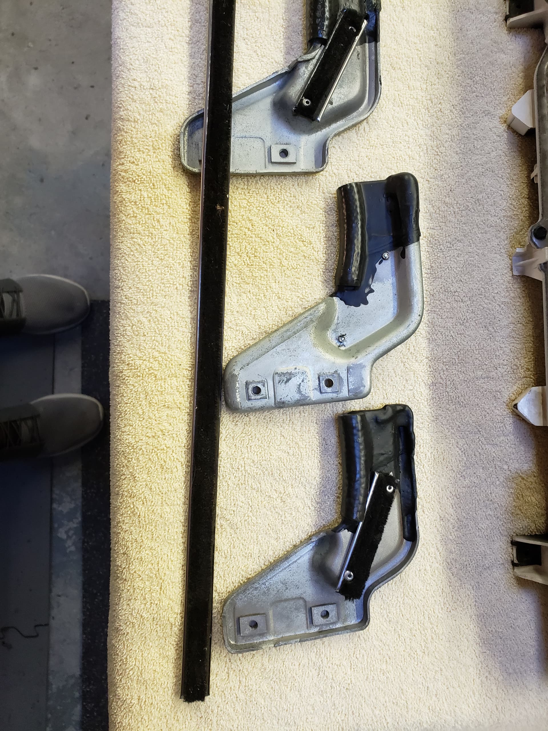

Here;s how I redo these stops. I have extras if interested.
Almost a must with power windows!

The piece in pics is all i have left. Would like to save for future needs BTW, I media pieces, remove old dip, and then redip in Plasticcoat a few times, then rivet w/x on.
