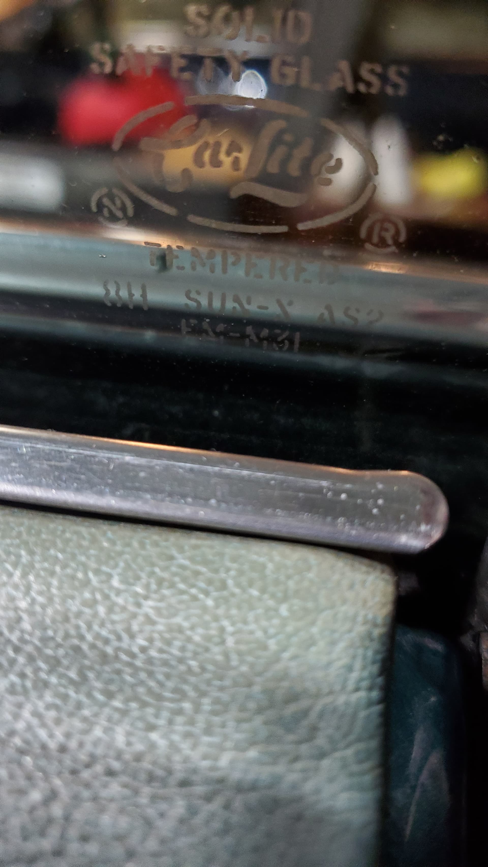

You should check all 5 pieces of side and rear glass. They should all match. Factory tinted glass has “SUN-X” etched in the glass. It all needs to match or will stick out like a sore thumb.

“You should check all 5 pieces of side and rear glass. They should all match. Factory tinted glass has “SUN-X” etched in the glass. It all needs to match or will stick out like a sore thumb.”
Thank you, I did go around to all the windows, they are Sun-X except for the windshield.

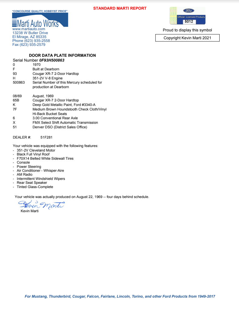

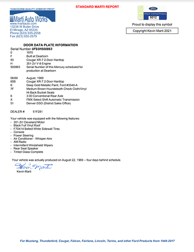

I don’t know the general answer, but my '70 XR7 has factory A/C, and clear windows. My Marti report doesn’t show any “delete” option, so I don’t think A/C meant automatic tinted windows, at least in '70.
I used confusing terms - the tinted windows would automatically be triggered by an AC option but the dealer could get around it by placing a special order and not specifying the tinted windows. If you have the Marti Report, what is the “Order Type”?
In other words the dealer could delete the need for tinted windows with an AC order. Your Marti Report will only show the options that were paid for.
Hmm, I mis-spoke, as the Marti report says it does have tinted glass, but it’s very, very clear, so if it was tinted, it was incredibly light. Of course, the Marti report also says it was delivered with a 2bbl 351 Cleveland, but it most definitely has a 351 Windsor.
