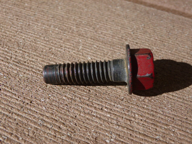

I think you have the 5/16-18 but I think they are 1 1/2 inch with a shoulder.
They are 5/16-18 x 1.125 long.

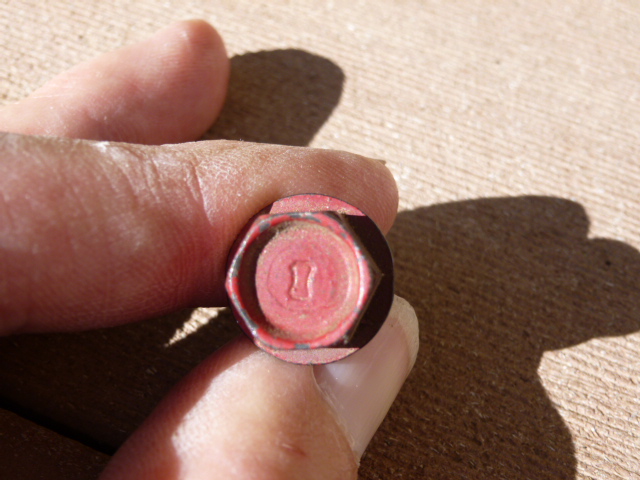

Here is a picture
Yep, that looks like the one.
Perfect. Thanks all. I was curious if they had threads all the way to the end or if there was a lead end on it. Your picture explains it all thanks Trixie.
