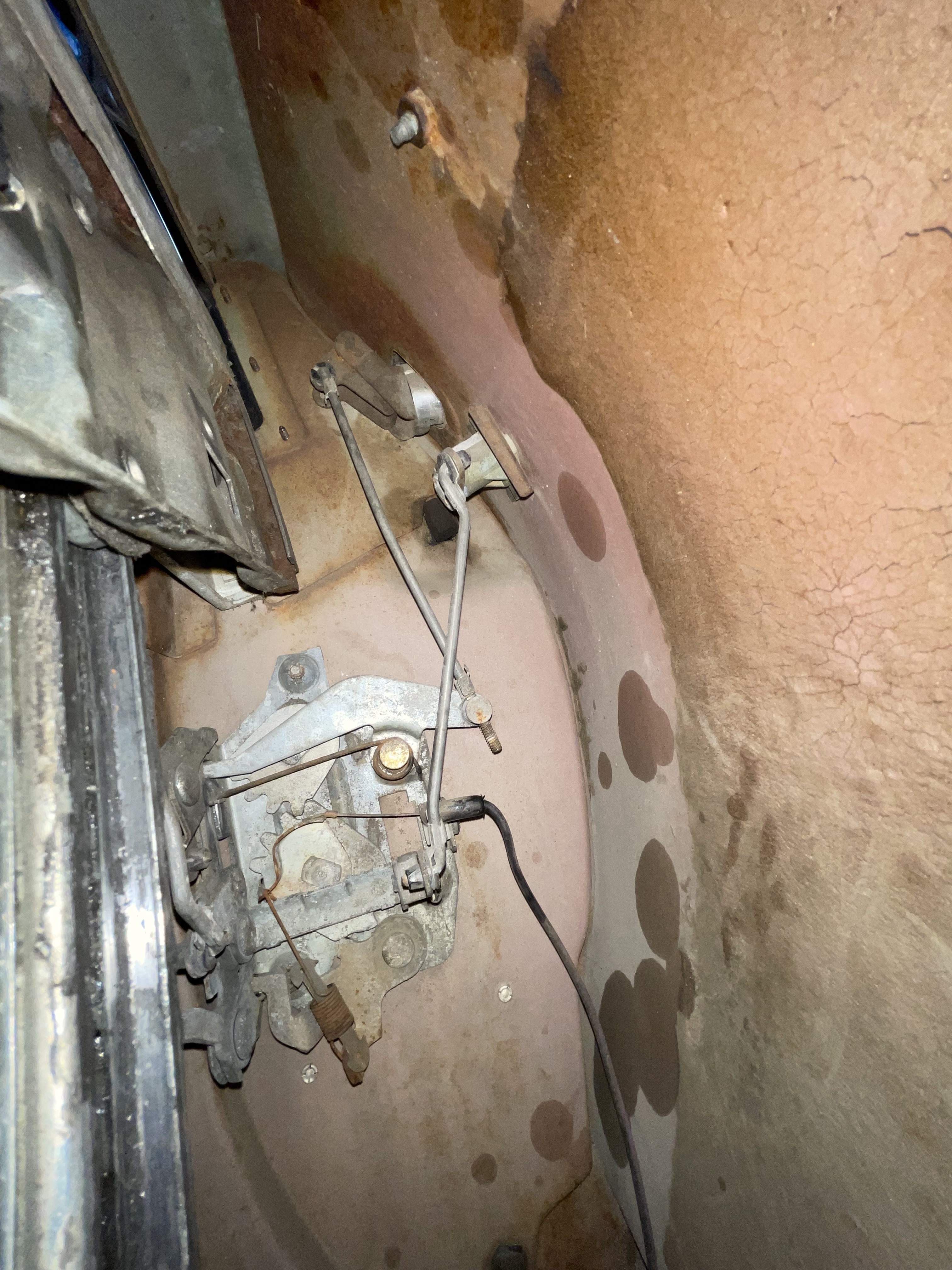

When I pull up and hold the door lock and. depress the door handle on the outside of the drivers side door, the door opens. But the door lock flops right back down when I let it go. Which keeps the door locked.
What’s wrong with my mechanism that the door lock won’t stay up in the unlocked position? I looked in the door and in the service manual but can’t find a remedy for my particular issue. I took a pick inside the door:

I believe that there is a spring, or something, that keeps presure on the mechanism that holds the lock open or closed.
There are three springs in each door latch. The springs often rust out causing the issue you describe. You can either make springs from new ones at the hardware store or replace the latch.
Thanks! Silly question but I presume that to replace the springs I have to remove the door latch itself? I don’t see another way.

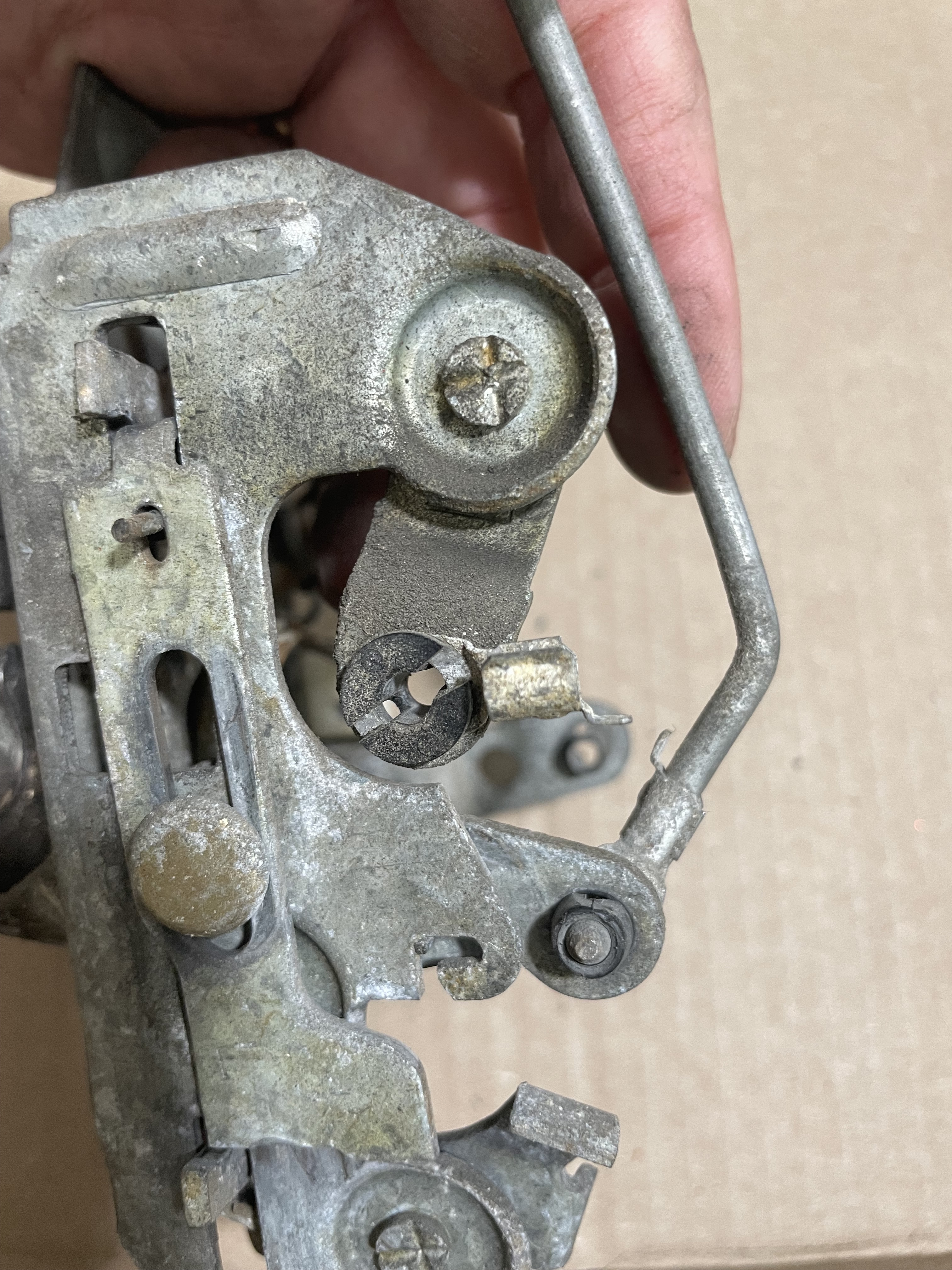

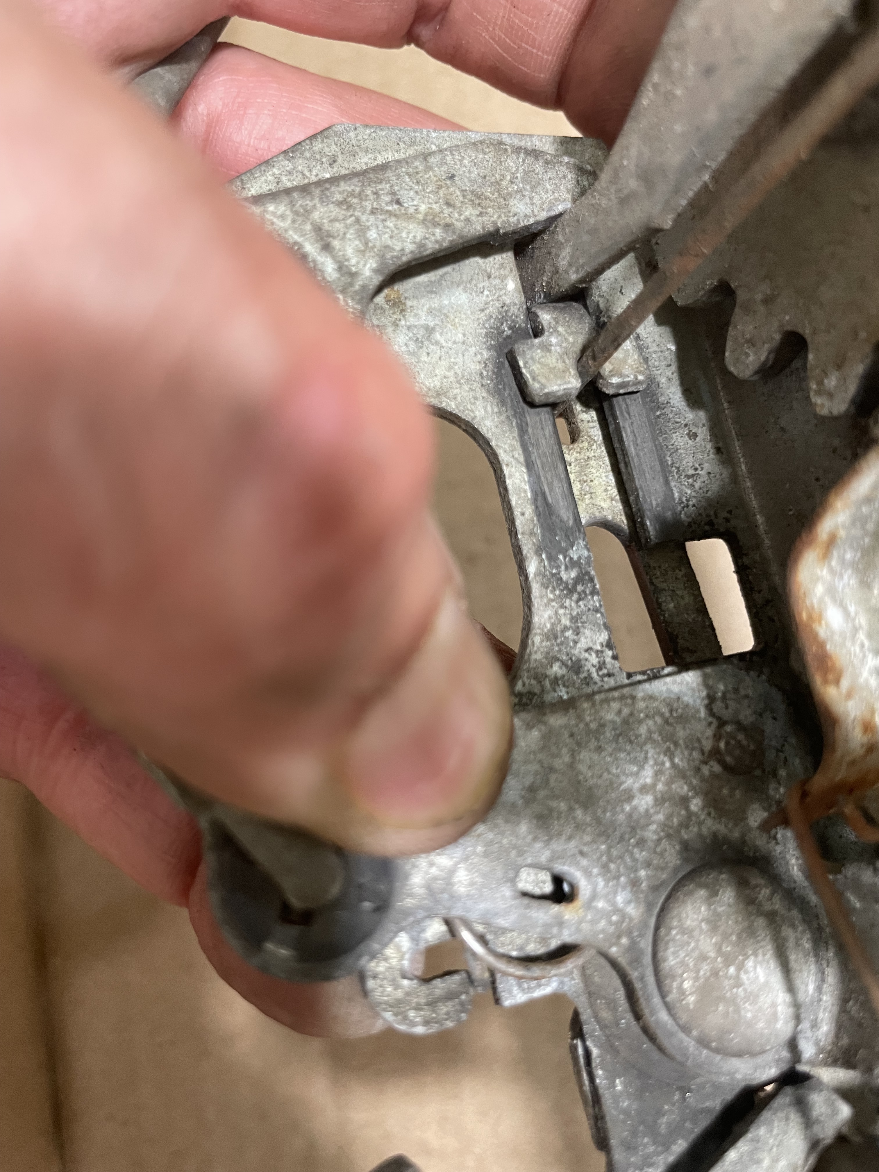

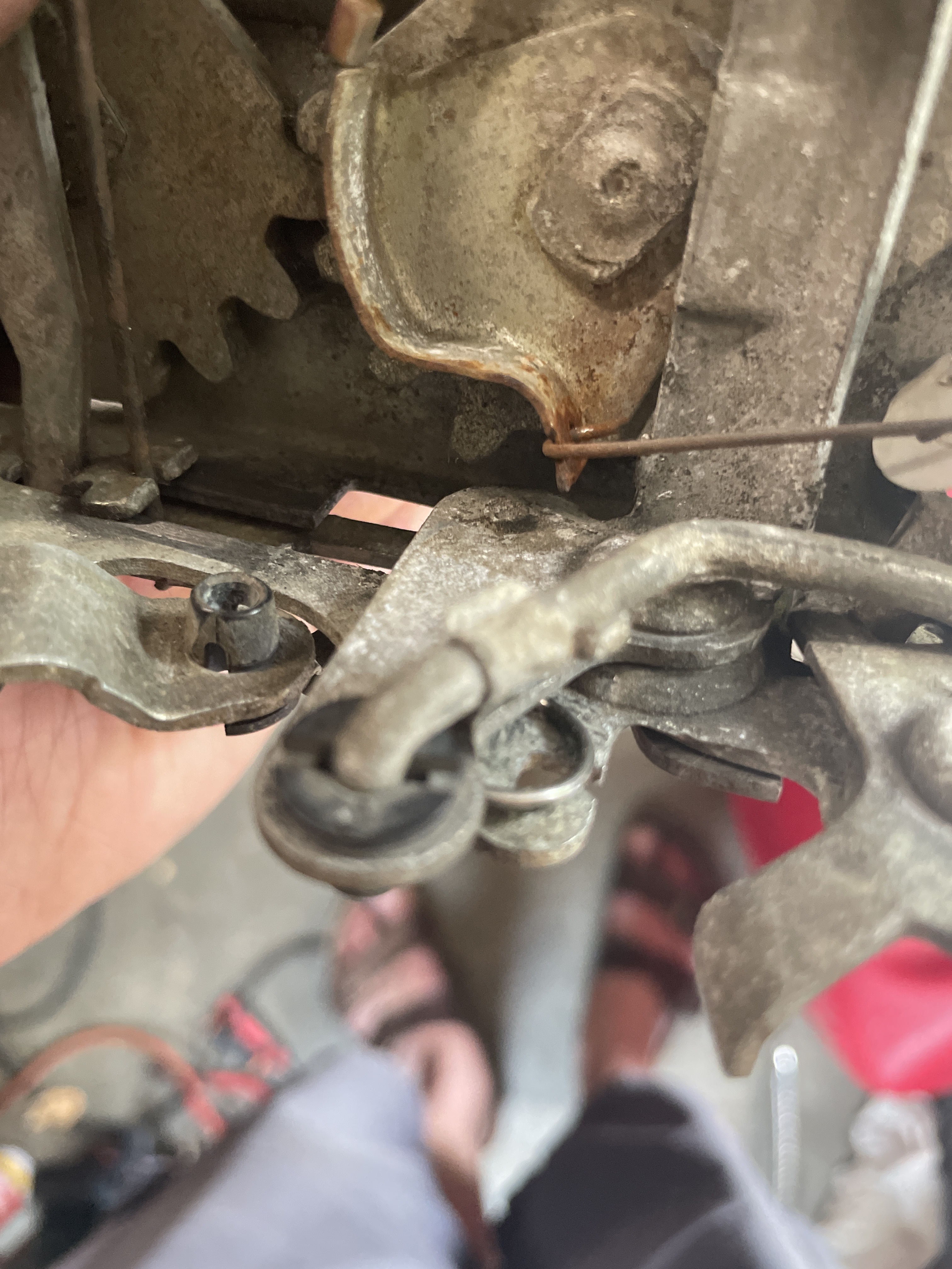

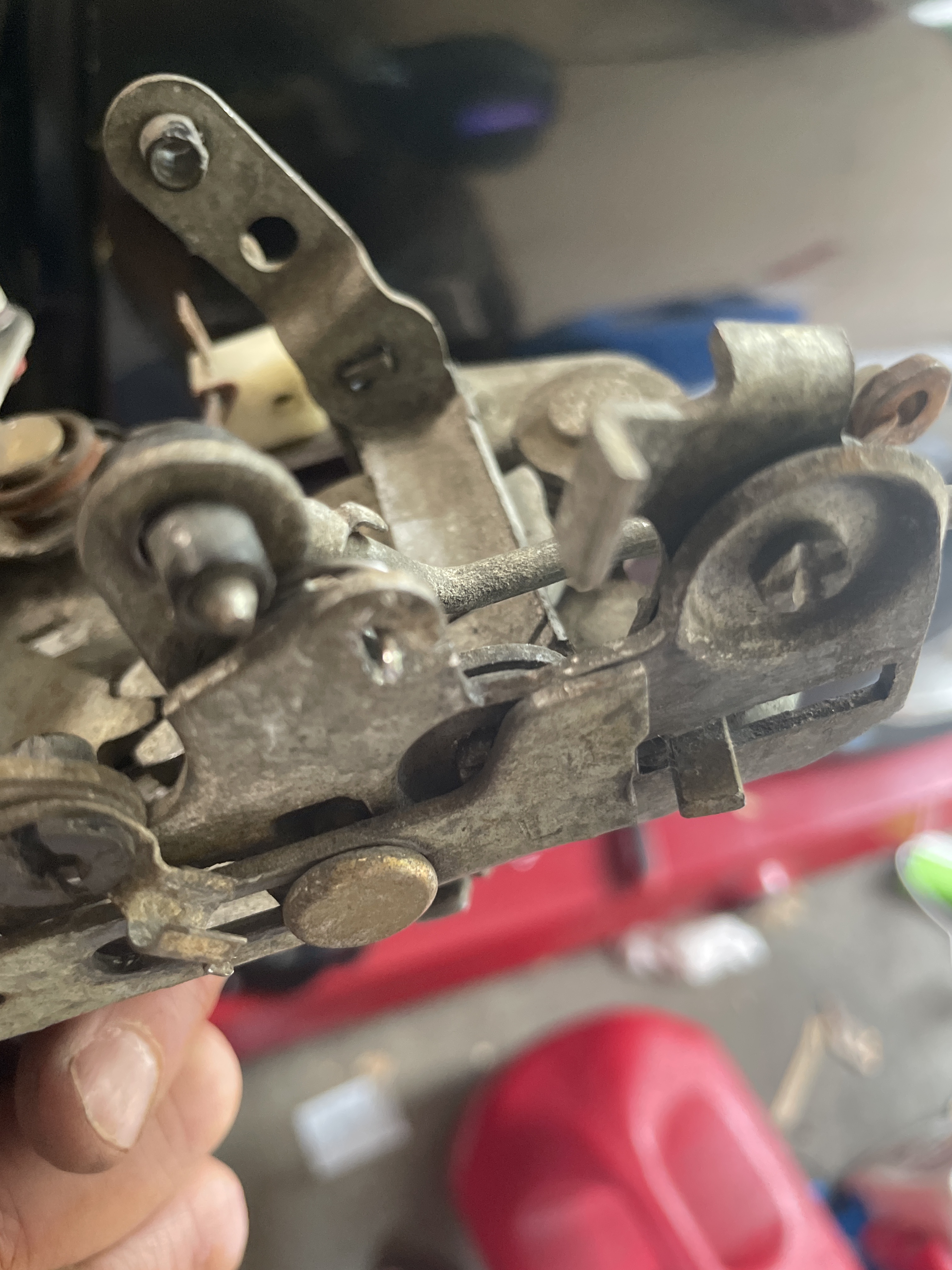

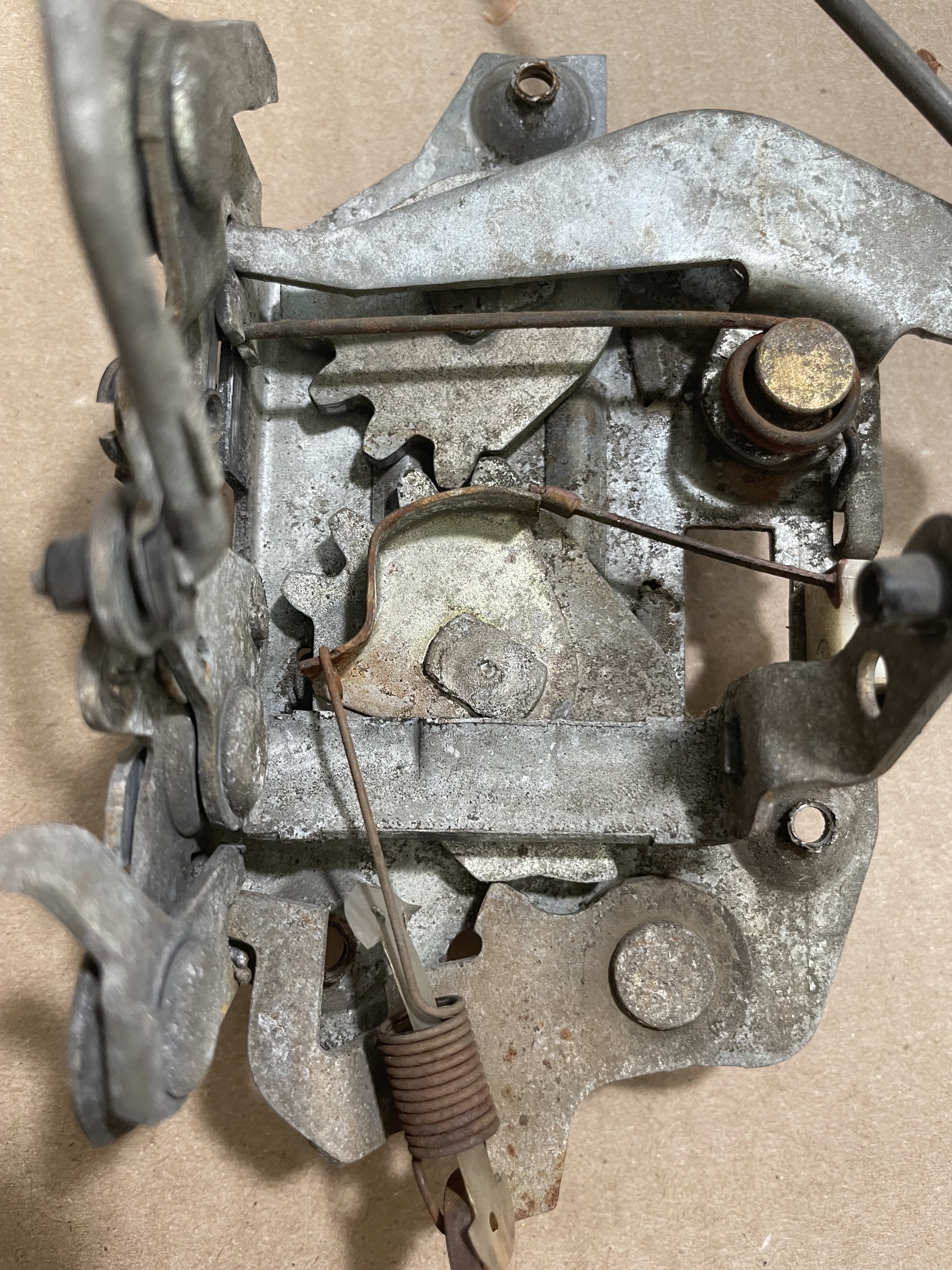

Success! I removed it. I can see 2 of the 3 springs which appear to be ‘springy’ enough.
There’s a third, by my thumb that looks like it should be a part of the lock/unlock mechanism, sandwiched between 2 plates, that appears to not be doing anything. Is it serviceable?
Specifically, the small circular spring… i can’t tell how it is supposed to be attached… if I could get a photo or illustration then I could probably fudge a hardware store fix.
Or could it be something else?

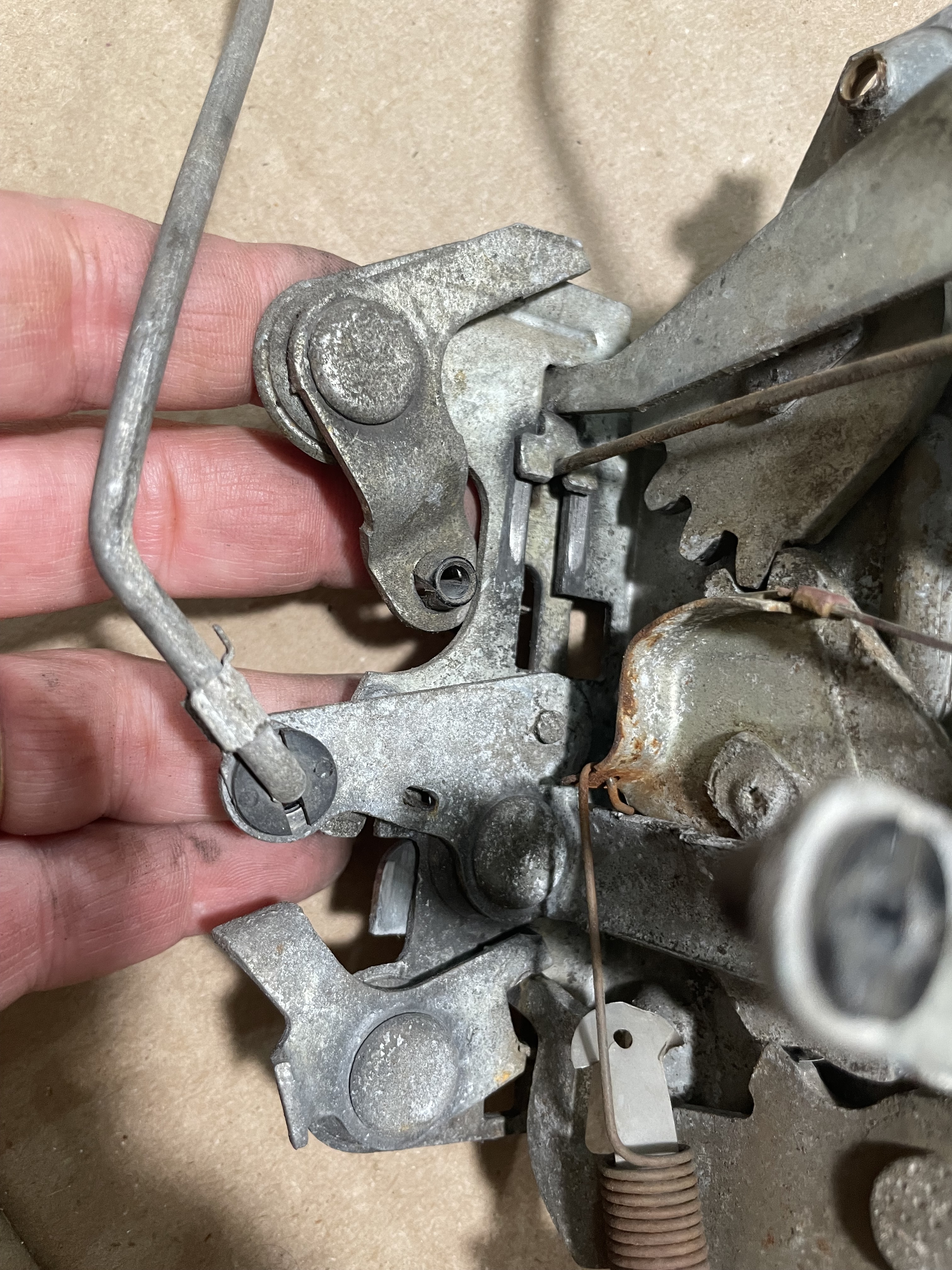

Created a new spring after a run to HW store and modifying a spring I bought. Mechanism works now. A little hard to see but here it is installed.

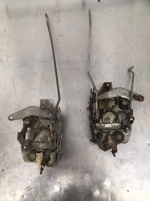

I had to take out both door latches to see the difference. You might have to also.
If the repair works great.
