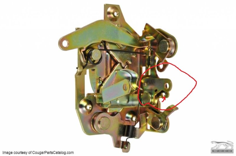

I took the passenger side out yesterday. Got it on the bench. The rod that controls the up and down door lock has no spring on it. I have searched the web a bunch of times and have seen a few glimpses of a little spring or spring clip but nothing 100% for sure. So frustrating because everything else is working perfectly on that latch.
This is about the best picture I can find. I circle the area and pointed to the spring I need.
