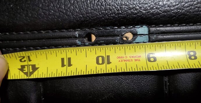

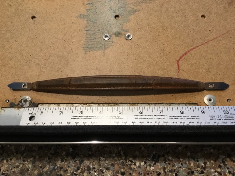

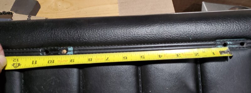

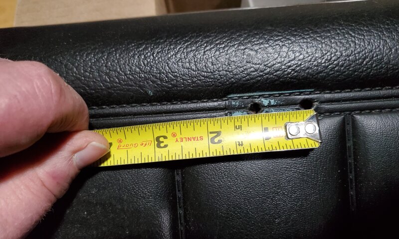

The holes that the mounting bolts(screws) go through are about 9 3/8 inches center to center. the alignment holes are 1 1/8 inch farther out.
Note, I used a 1969 XR-7 panel, the door pulls are the same for 69 and 70.
Getting a good picture that shows that I have the tape measure centered on the forward hole is hard with the phone.

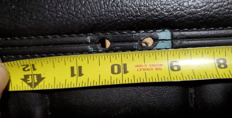

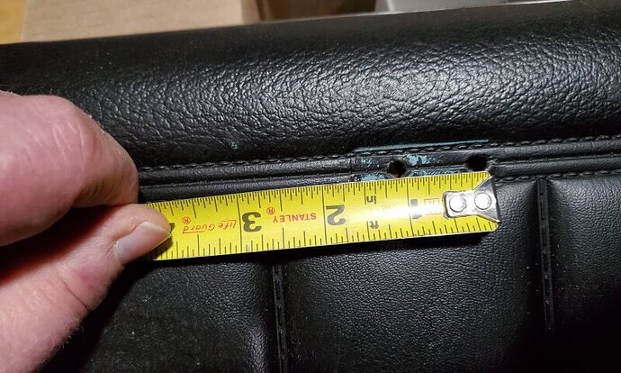

Close up of the measurement

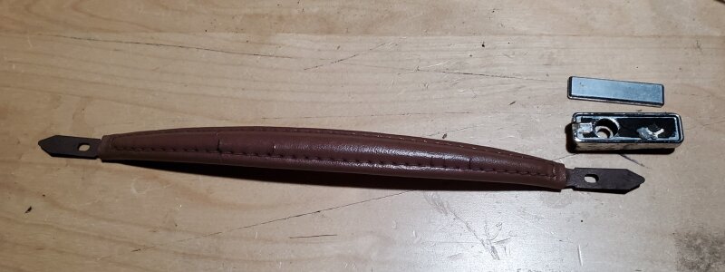

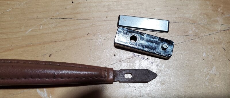

This is a correct door pull and one of the 2 sets of end caps.
Bottom side of the end cap.

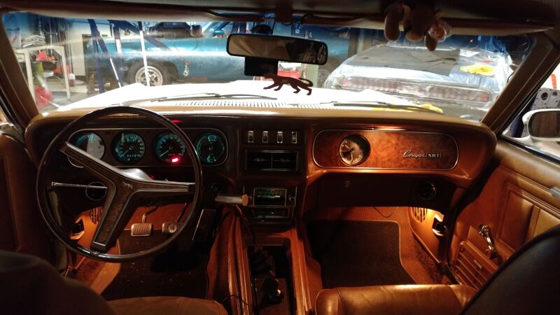

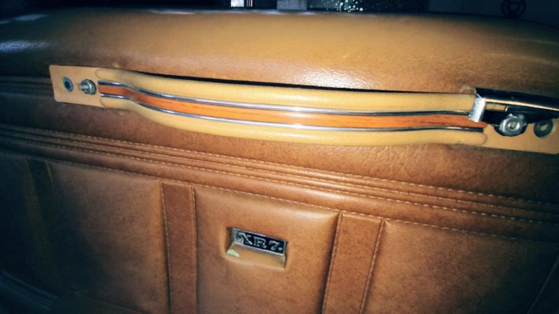

I like the 70 Ginger XR-7 interior. Here is mine.
My 1969 XR-7 ( San Jose assembly ) has white door pull straps, and they were screwed through the interior door panel into the door inner metal skin.
The long screw has a blunt end on it, and was therefore not a self-tapping style. The chromed bezel and the screw were held together by a tinnerman-style / push-nut on the back side of the bezel. The screw could then spin freely in the bezel and be tightened through the pointed tang end of the pull strap ( which inserts into a slot in the bezel )
The pull strap and chromed bezel were then positioned on the door panel ( the lugs on the ends of the bezels match pre-embossed holes in the vinyl ); the screw is tightened down, and the brushed chrome cover is then installed.
Originally the metals covers had a small strip of 3M double sided adhesive to keep them in place.
