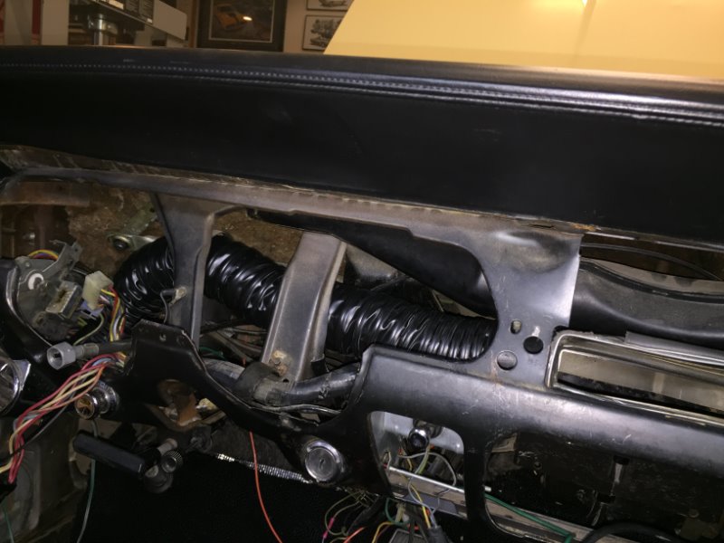

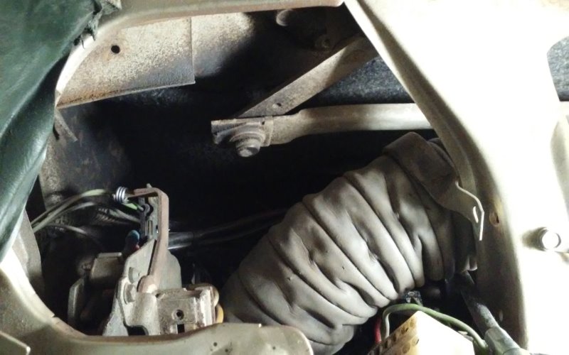

It’s a heck of a lot easier with the instrument cluster out. Here is the new hose I installed in my 68 XR-7. Don’t forget there are those curved brackets that the hose sits in. Good luck.

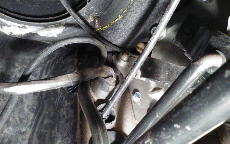

Thanks for the photo Scott. I broke down and took my cluster out. There was just no other way. Found the curved bracket that’s used to retain the hose. Just gotta get it in place now. So does anyone know where the vac lines route, in front of wiper motor mount, (between cluster and mount) or through the mount? Also note where I have my cable running. Is this the right place? Also included a photo of a tapped tab under the dash that don’t seem to have a use for AC stuff. Is there a dash stiffener brace that goes from there to the bottom dash lip?

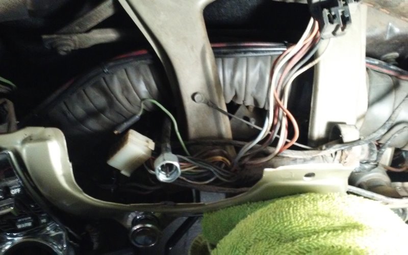

Here are some photos I took of my “mess” :unamused:
If you Google “1967 mustang a/c vacuum” and click on pictures you will see the hose routing by color. You can also buy a kit with reproduction A/C vacuum hoses that has a diagram as to where they go.

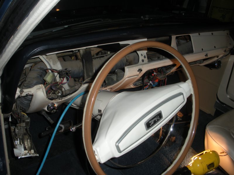

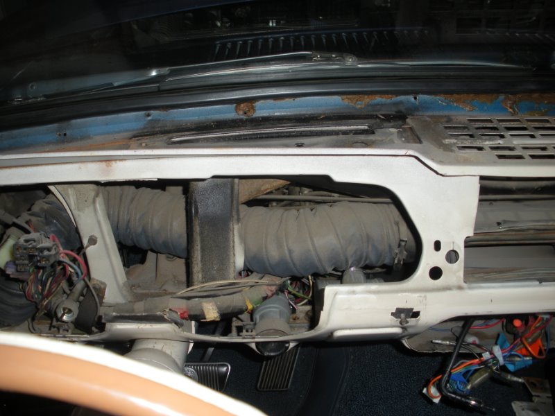

Here’s a picture of my passenger side dash area and there is no easily visible brace that I noticed.

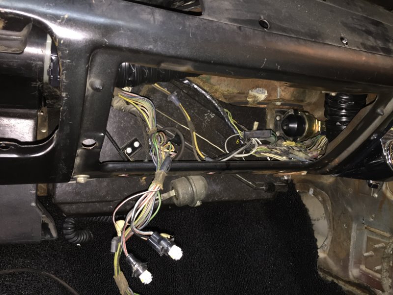

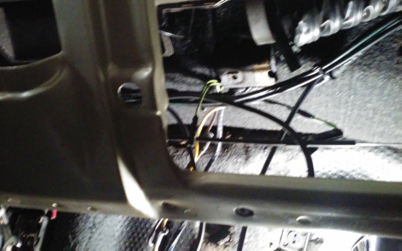

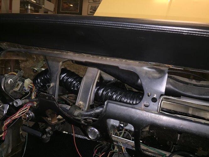

Here are a couple of pics immediately after I removed my instrument cluster on my 68 back in 2012. Nothing was disturbed yet. It looks like the vacuum lines split up after curving behind the vent hose. Hopefully this helps.
