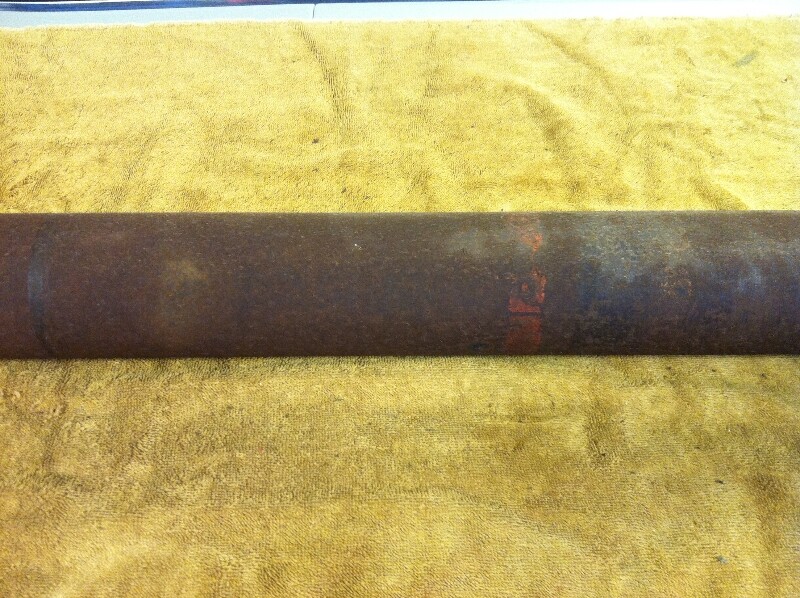

I need to clean up and re-finish my driveshaft before I reinstall it as part of my ongoing restoration. I want to be correct with the color and finish. I realize it is to be a natural unfinished color, but I’m trying to find out what the color stripes are supposed to be. After some cleaning with steel wool and WD40 I can see the 3 stripes, but they are so faded I can’t make our the colors. I have not been able to find my car’s build sheet. So can any one here give me some advice as to the proper color paint stripes or and other daubes?
I’ve tried a site search here with no luck. WCCC has a picture of a used one on their site with colors of Red, Yel, Grn. But its only identified as being for a small block, but I’m not sure if that is specific enough.

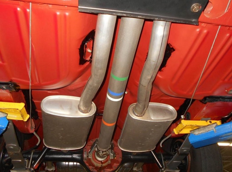

Here’s what mine looks like on a 69 XR7 428CJ with C-6 transmission.
Doug - do you have a build sheet for your car? I don’t have one and your R-code should be the same on most things as my Q.
I don’t have a build sheet for my car. :frowning:
I’ve also got the 3.25 traction lok if that helps though.
MrEos: thanks for the info. That picture on the WCCC site was the one I was referring to. I just was not sure if it was correct for all small block cars. I thought the color codes on the driveshaft could differ by engine and trans or even axle.

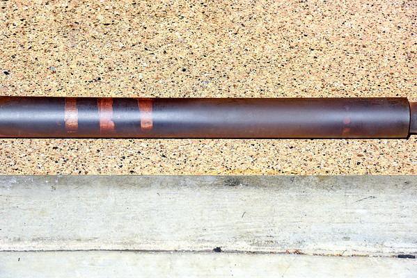

Well I think SCode may have hit the nail on the head, I cleaned up my drive shaft up some and the lines started to reveal, they are very faded but they look like they could very well be Light Blue-Pink-Pink with a Red stripe near the axle (or maybe the light blue is white), though it appear mine are in a reverse order. Look at this picture. What do you think?
I’ll try to get a look at my 68 J code convertible conversion and see if the stripe markings are visible. It’s a San Jose (8R91) build. Everything under the front end was real crusty and dirty but I could see the markings on my front springs so maybe there is luck for the drive shaft.
Well I looked yesterday evening and no markings are visible on my driveshaft. However it is a two piece unit just like what is shown in the other posts.
Just cleaning up the DS from my 68 San Jose built (late 1967 build date) J Code 4-speed. All original down to the factory exhaust and it is a single piece DS. Only found red and yellow stripes so far but they are spaced a bit further apart than in the WCCC pic.
