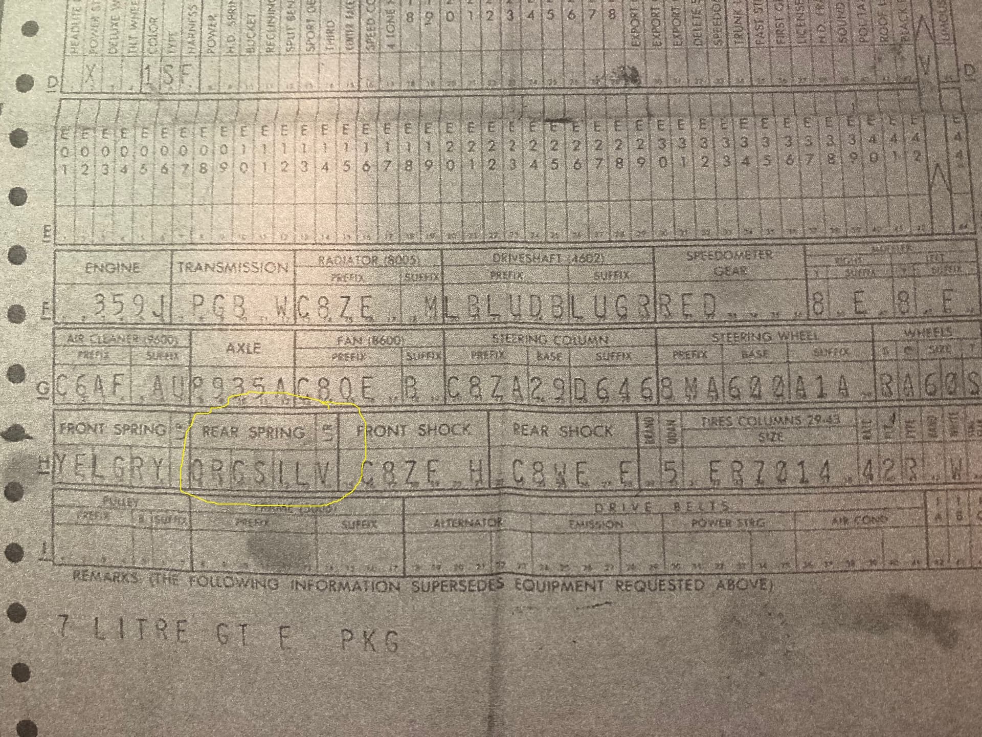

So far I have not seen a 1967 Cougar with the competition suspension and a buildsheet. I have seen the build sheets on two GT-E’s which have the competition suspension standard. On both of those build sheets it lists the C7WA - N rear springs.

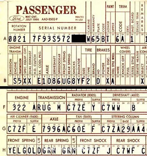

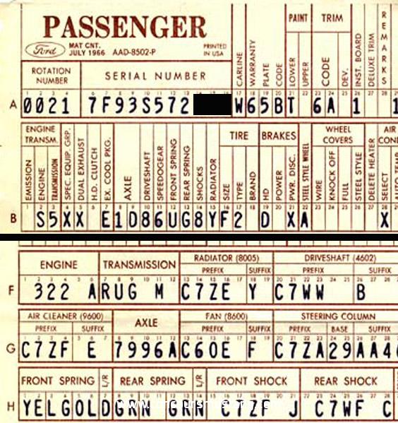

Thanks - thought that (no comp suspension) might be the case. So for a sampling from the 67 S code 4 speed with AC buildsheet I was referring to. Does show the Special Equipment Group (line B #4) and the 1 green - 1 green stripe for its rear springs. Happens to be one of the nicest buildsheets I’ve come across as far as legibility.
Hope this helps
OK Jeff So would that indicate grn/grn on the top leaf near the rear shackle mount or grn/grn on the smallest bottom leaf like I showed photos of?
The stripes go on the leaf stamped with the part number. Yours have the remains of the original stripes.
