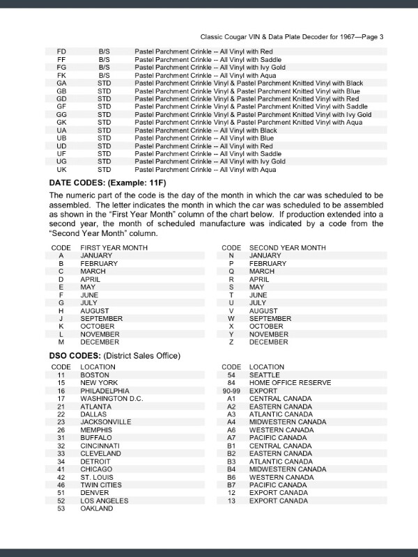

Another thing to remember about DSO codes. Ford and Mercury did not use the same numbers. IE, Ford for Seattle DSO was 74. Mercury was 54. As Royce said, Neither Ford or Mercury used code 67. But as Bill said. Mis stamping’s happened.
Greg,
A Marti Report would give you some of the missing details and certainly is worth ordering to learn more about your car. Have you visited http://www.cougarclub.org and entered the door tag information into the VIN decoder. What else can you share about your car?

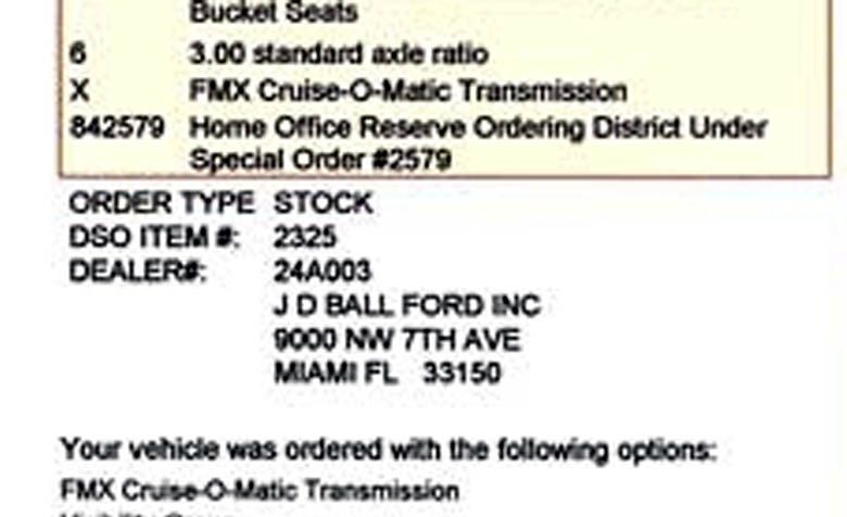

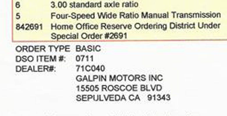

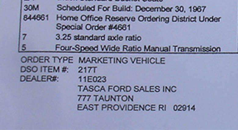

Looking at other Marti reports with 84 DSO I found that a report can include where the car was shipped, if it was part of a special order (and will include that order number)
Home Office Reserve appears to be somewhat of a catch-all used for many different purposes. in 68 it was used to route the Shelbys though the term “home office reserve was used” they used a 8D rather than the 84 coding on the door tags
A few examples
Noticed that most appear to be nothing really special or cars that would stand out at first look- well except for the first example
