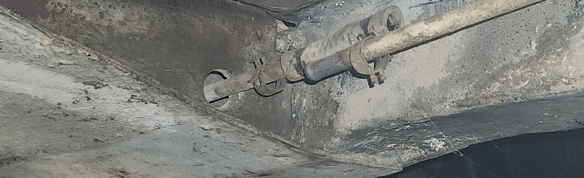

Yes, it is just a hole. Here’s a view of approximatation.
I have never seen a ‘67 or’ '68 run the fuel line any other way except through the torque box, along the unibody frame, take a left untill the pinch weld. following
the rocker untill the front leaf spring mount.. ect.

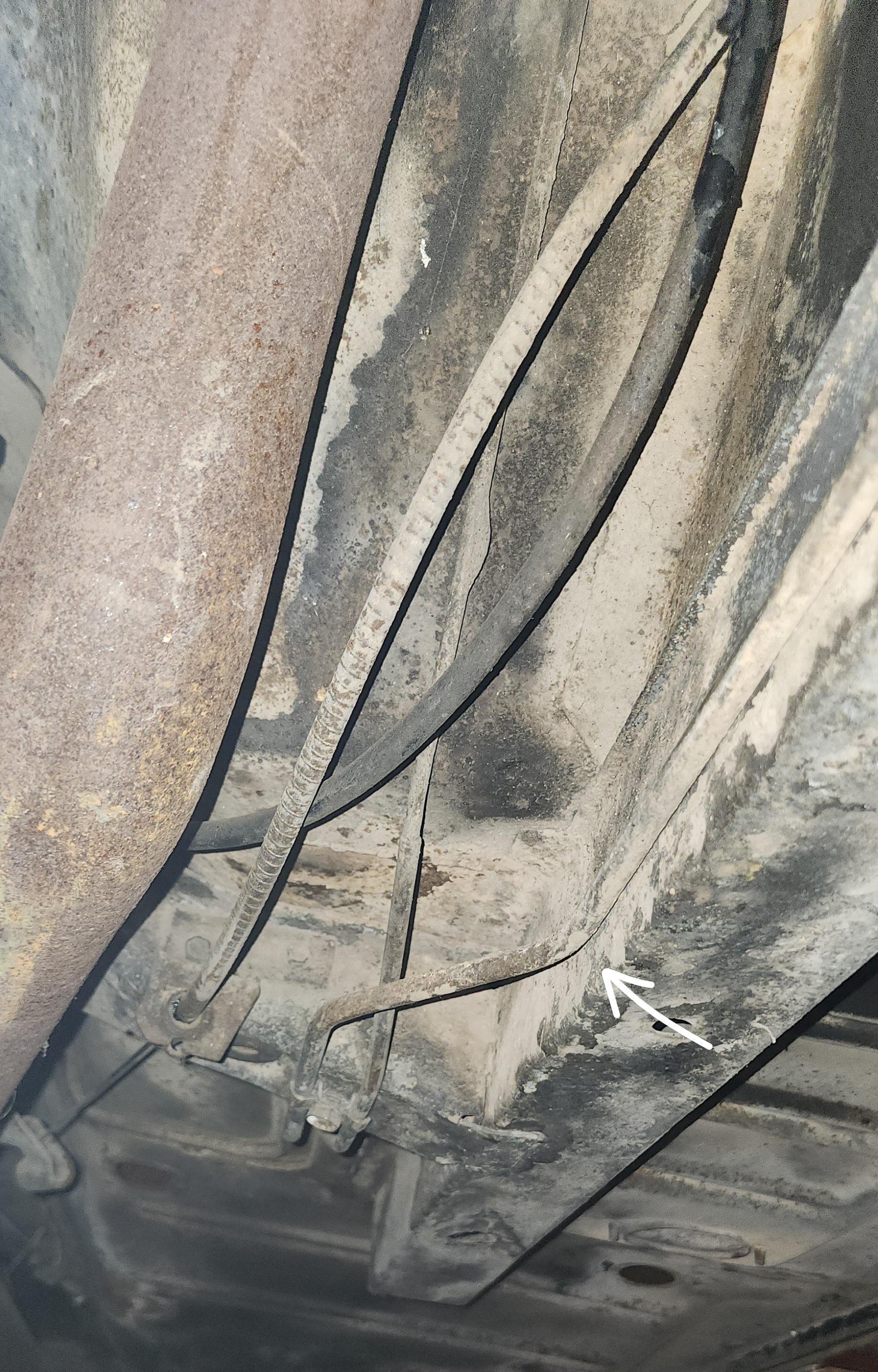

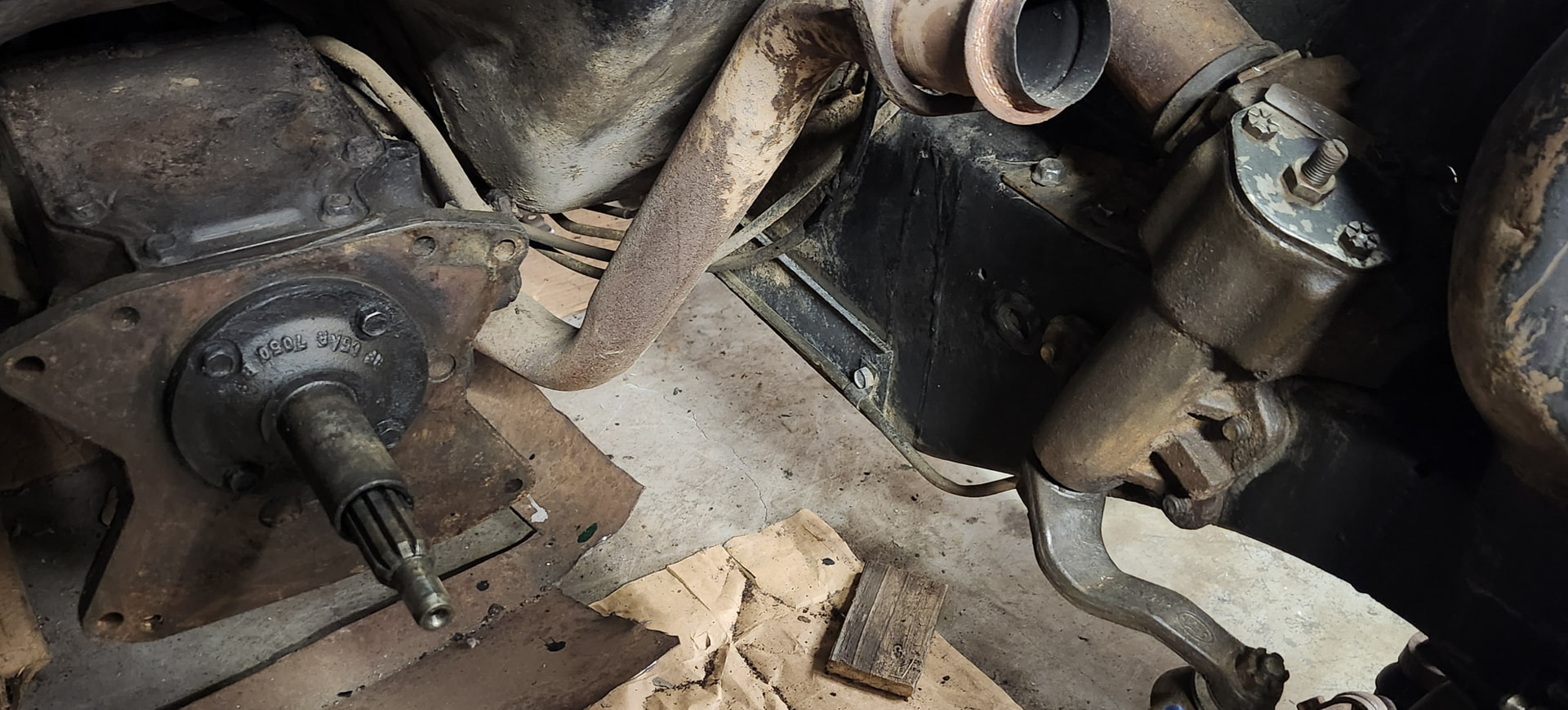

I thought it was the right hand torque box that was not installed on the 67’s. My car does not have one on the passenger side. It sure looks like there is one on the driver’s side, minus the hole being discussed. I’ll see if I can figure out adding photos to the post.
Thank you, that will help! My cars birthday is 12/66. The fuel line is tucked up in the transmission tunnel and kicks out just forward of the torque box to follow the frame rail through the suspension like the front section of the 2 pc line.
Correct, I mistakenly said otherwise.

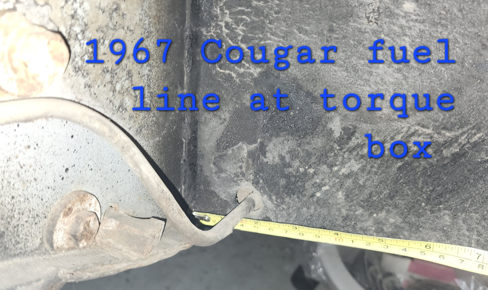

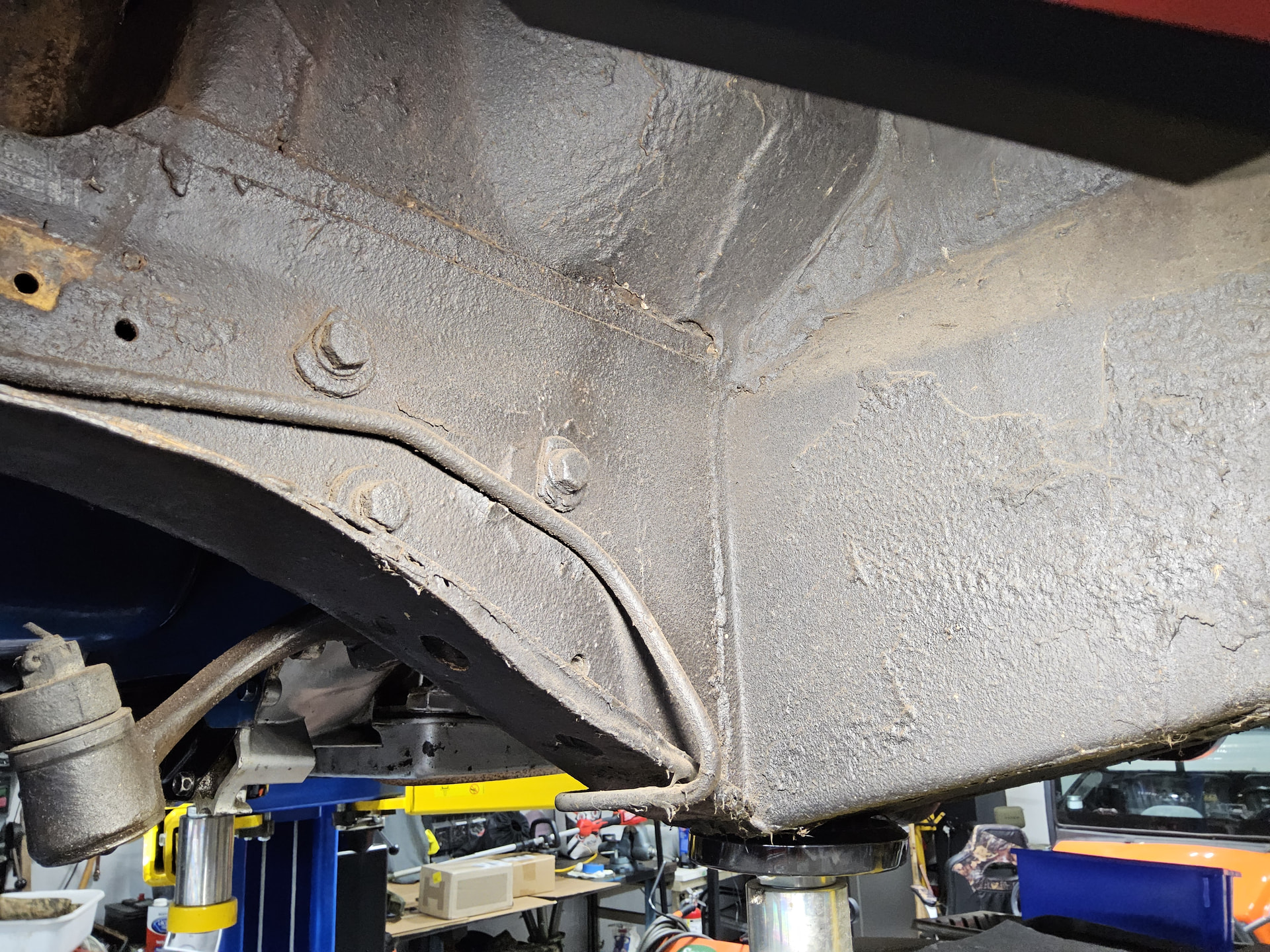

This is how my fuel line transitions out to the wheel well from the transmission tunnel.
Yes, I’m scared to see what is under the undercoating.
So, to be clear most 1967 Cougars ran the fuel line through the driver’s side torque box. Your route is that of a 65-66 Mustang. Here is a view of a 65 fuel line route.
Your torque box might be correct without the hole. Early production Cougars and Mustangs didn’t run it through the torque box, I’ve just discovered. Hopefully you have one of them. Some safety laws may have gone into effect moving the line away from the drive shaft. Too bad because that decision rotted out a bunch of cars.
