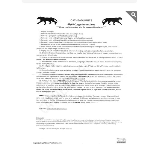

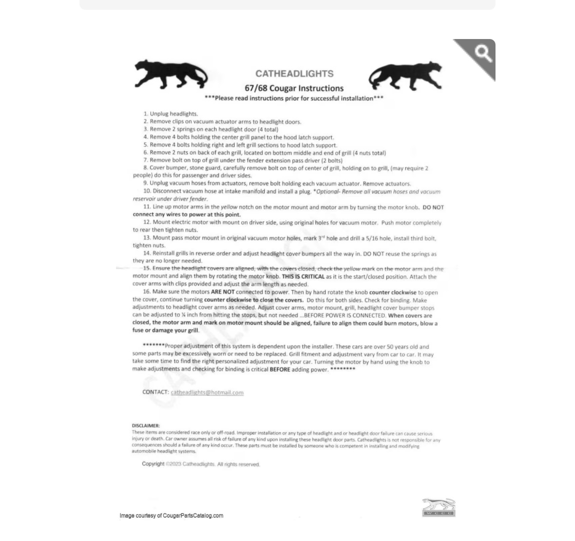

Do you have to drill holes to install the new electric headlights on a 67 Cougar
Yes.
I did not have to drill any holes other than a separate ground attachment.
