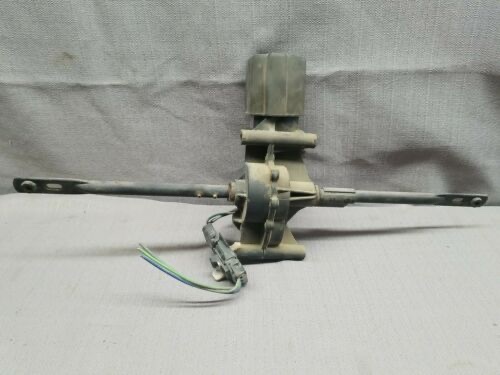

I think a headlight motor from a 1980’s Oldsmobile Toronado would be good for a Cougar application…
No longer available new from GM / AC Delco - but tested used motors are out there for cheap.
Dual shaft and designed for a central mounting location like the 69-70 Cougar vacuum motors.
Just a thought
