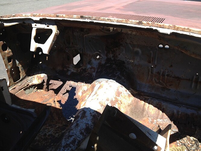

I took my trunk lid down, and on pulling up I see this:
…and think, why would someone try to bring this back to life?

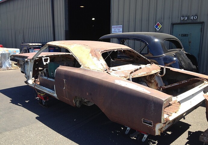

Well, if you are Graveyard Carz http://www.graveyardcarz.com/video.html from the Velocity channel, and you found a rare Mopar (like 6 figures rare), I guess this is where you start. (I will let you ponder which until the end of the thread, but the sunshine shows why this is a rare model of a rare car):

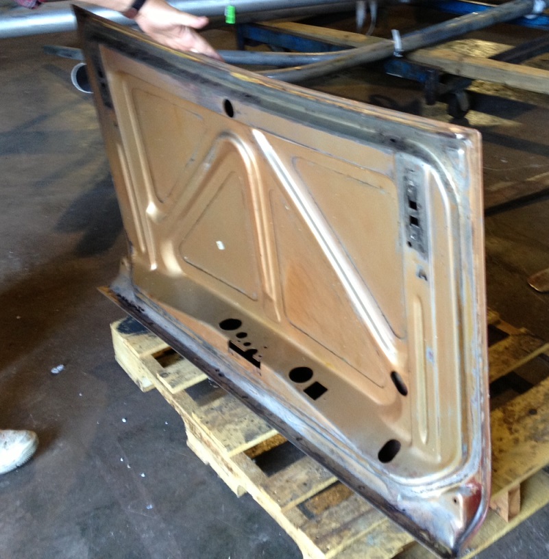

So they have my trunk lid, which I thought would be a good test of the process. It has some minor issues, and I want all the crevices clean:
It will be $165 for the stripping and rust removal, and $25 for a heat/pressure treatment of Iron Phosphate for a paint ready surface. It is twice the price from the chemical guys, and the stripped body will run $1000 more at $2800, if I go that route :wtf:
It should be ready end of next week, at which time I will put up photos!
Oh, the car above is a Plymouth Super Bird, 1 of 3 built with a column shift. (No hole in center cowl) Note the large tail fin mount area.

Ya, they just sent him this car, so there will not be anything on it yet. Season 3 I guess.
No acid bath here, good thing 'cause there is not much left on that Super Bird!
Wow… I would think with it in that condition it would be cheaper to just find one in better shape.
As for the “rare column shifter”… as they say, rare does not necessarily mean desireable. Unless it is a Hemi car, eh?
