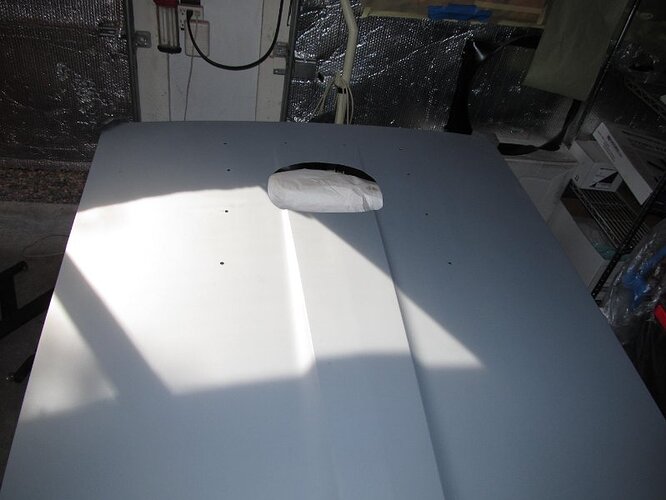

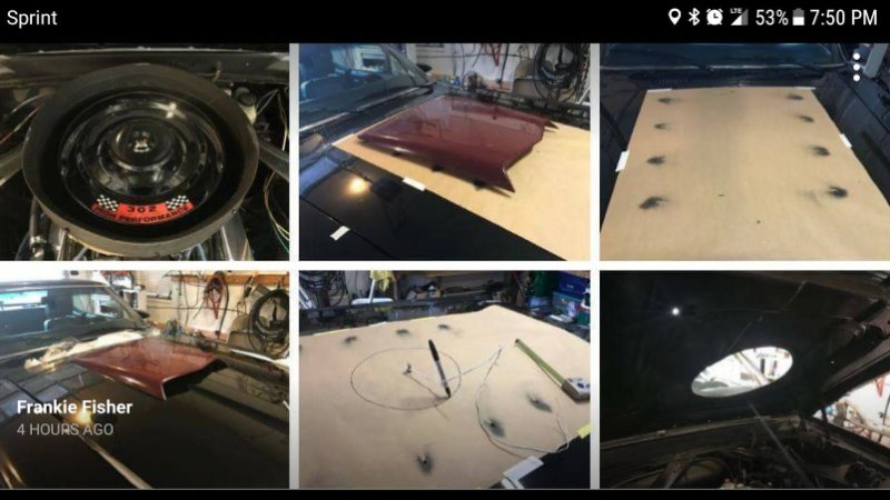

Here is a photo i pirated. It may help line up to drill holes to install the scoop.
That’s outstanding!
Thank you!
Make sure and put holes big enough to get a socket on the scoop’s hold down nuts. Some holes will be in the reenforcing ribs of the hood.
That is a great tip!

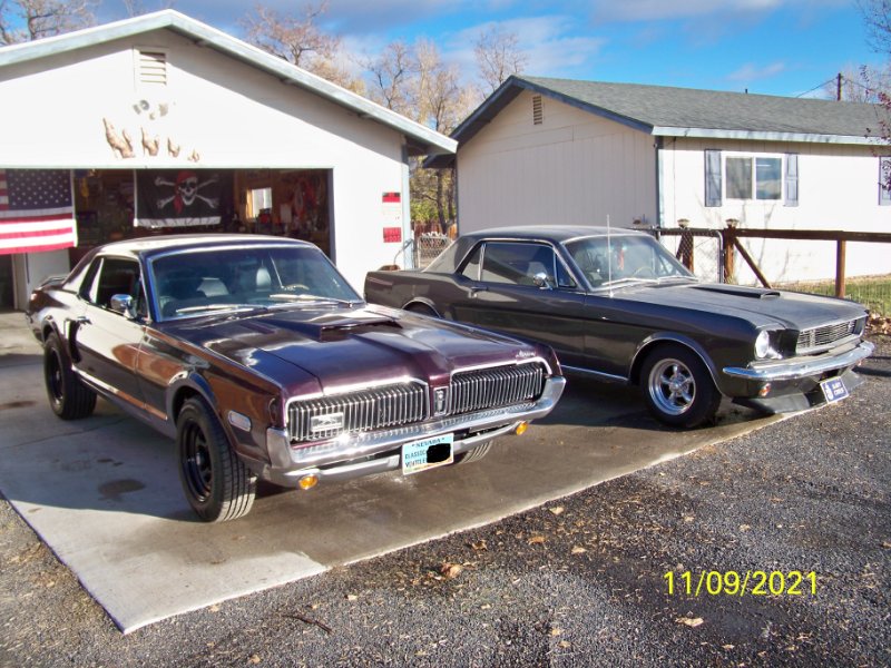

Yours looks great. :sunglasses:
The 66 looks pretty good too!
Thank you, Brian

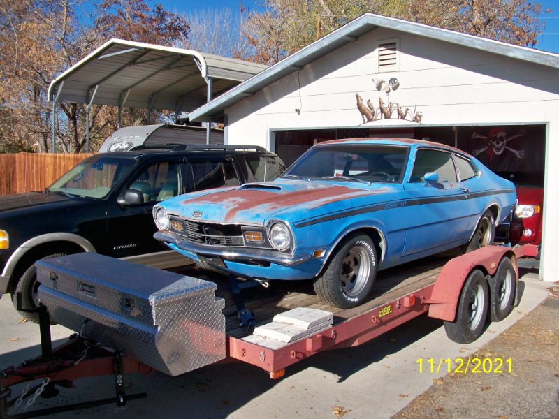

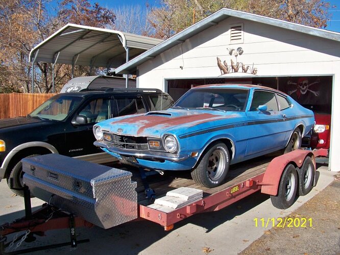

One thing I did notice when you buy a “replacement” scoop is the studs for it. Replacement ones don’t have the built in washer stops on the top of the hood side. So it’s easy on the newer scoops to tighten them to much and pull the studs out of the fiberglass. I have both types since I have a 72 Comet GT now. Funny how it has a C9 part number which is the same for Cougars.

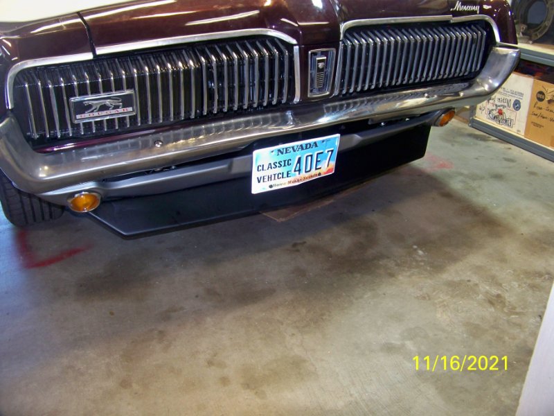

I had trouble finding a good front spoiler. Then I seen a picture of what another guy had on his 68. It’s a 69 Camaro one. Fits pretty close to. even without the braces.
The Stang is hers. Bench seat. 1 of only 15,000 made in 66. And they made a butt load of Stangs. Even ones with bench seats had them removed by dealerships. Cougars had the bench seats.
Thanks for the heads up on the bolts. I will be sure and put a spacer or something on them to help avoid over tightening.
Love the Comet by the way! It looks pretty solid.

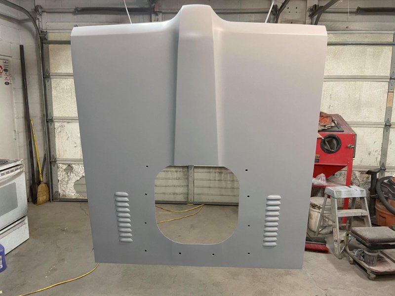

The hole cutout in the hood for factory ram air is not a circle, it kinda looks like a squashed jelly bean :smiley:
Keep in mind he seal is round so you want to stay inside the seal with that jelly bean.

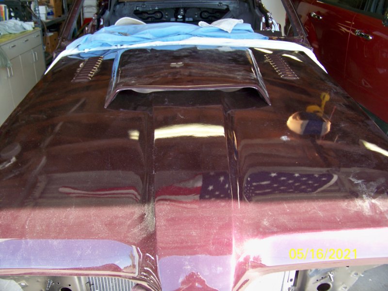

Here’s the only pic I could find

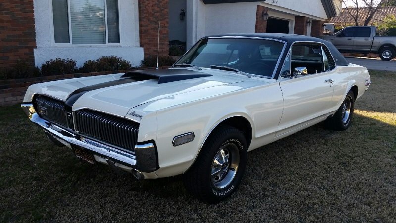

Here is my son’s 1968 (same as a 1967 right?) - we wanted the 1968 428 CJ look. The scoop is a 1969 original, and fits just fine.
That looks great! Exactly the same look I am going for. :slightly_smiling_face:
